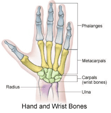

You probably could detect the thumb touching a finger by mechanically sensing the movement of the proximal (near) end of the 4 finger metacarpal bones. If you feel just distal (out past the end) of your wrist bones where the metacarpal bones join the wrist, you can feel each finger's metatarsal bone lift slightly when you touch your thumb to that finger. It might take some experimenting to see how good the signal-to-noise ratio is, though. You could make a sort of bracelet that extends just distal past the wrist socket to sense the movement of the ends of the 4 finger metacarpals...
http://www.physio-pedia.com/images/a/a2/Hand_and_wirst_bones.png

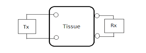

...for some reason I can't find the right keyword anymore, but a while ago I did some searching on some similar concept, and there's it seems to be some active research going on in this area right now.
Some things that showed up right before:
Body area networks: https://en.wikipedia.org/wiki/Body_area_network:
A body area network (BAN), also referred to as a wireless body area network (WBAN) or a body sensor network (BSN), is a wireless network of wearable computing devices
Intra-Body Communication for Biomedical Sensor Networks,
Comparison of Approaches to Intra-Body Communication
The basic idea seems to be to use the body as a medium to transmit/receive a signal.

Or with some kind of thimble? On the thumb that makes good contact to the skin underneath, and then measure the resistance/capacitance (or some other property, like frequency attenuation of an electrical signal or even acoustic/vibrational signal), when sent out through the hat, and receive again on the surface of the thimble... to discern between every of the 4 fingers. Or even those of the other hand?
