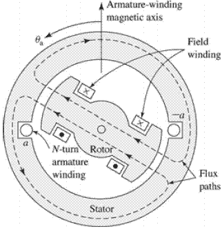

You may think of the magnetic field (B field) as something which goes out the north end of a permanent magnet and into the south end. Basically, the rate of change in the amount of this field going through hole in the coil is what matters for determining the voltage on a voltmeter. That is, in terms of what the permanent magnet does; there are other considerations like number of wraps.
In the image below, you can see how a design has a ring of material on the outside that is like a conduit for the magnetic field. This would be a high permeability material. This feature doesn't seem to be present in your design.
EDIT: In the design shown below the armature coil is wrapped around the rotor itself. This may be superior to the Stanford link for educational purposes, because it shows a magnetic direction switching inside some loops of wire.
Also, make sure your voltmeter is in AC mode.
If you have a data sheet for any of your permanent magnets, maybe you should make an estimate of output voltage magnitude based on RPM, number of turns, core material, and estimated flux linkage (maybe just assume perfect linkage and expect some percentage of that). This way you might have an idea of how to set the voltmeter, and that your device would produce a reasonable voltage.
