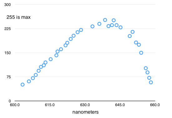

In any event, I went ahead and digitized my Omic spectrum, using @lpetrich 's most awesome tool, found an equation: y≈m λ D / d
where
m is the order
λ is the wavelength
D is the distance to the screen
d is the spacing in the grating
determined that "D" was something that would be boogered, as there are lenses and stuff in cameras that would throw that off.
So I decided that since "D" and "d" were both constants, I could kind of throw them out,
yielding me that with that at m=1,
y would be proportional to λ.
Given that I had 4 reference points for the Hg lamp, I determined from the blue and right yellow bars' positions and reference frequencies,
Code:
X       R     G     B   color         nm reference   Omic nm derived
57     39    60    66   blue          502.5          502.5
248    38   143    74   green         546.1          549.3
361   210   229   132   left yellow   577.0          577.0
369   231   224   125   right yellow  579.0          579.0
an equation that yielded wavelength, based on the x-coordinate: λ = 0.245 * x-coord + 488.5
Given that my green bar was only off by 3.2 nanometers, I decided to plot a graph for the red LED, which is what the OP originally was asking about:
Not quite right from what I've seen, for the intent.
But anyways, fun project. :smile:

I guess it's because no matter how hard I try, I can't get the lines to match up in all three images.
Your strategy (comparing relative lines pacing) is good, but if you are using a lens to image the spectra, if the lens has distortion (nearly all do) it will warp the line spacings. So you could actually be measuring the lens distortion- my guess from your image is that your lens has a few percent of barrel distortion.
I'm not sure what you are showing here- the LED spectrum looks very reasonable (assuming the camera sensor has uniform sensitivity across that wavelength range), I'm not sure why you are comparing the LED emission spectrum to the absorption spectrum of chlorophyll.

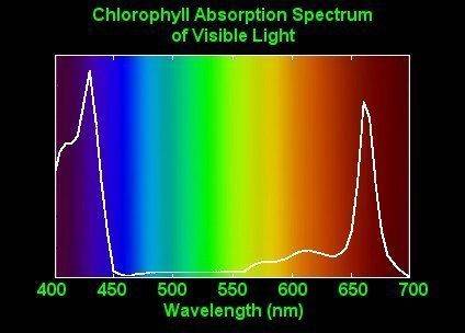

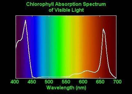

By eliminating the 520-630 nm wavelengths, it looks to me like you can grow plants with a lot less power.
[ref 1: wiki: Sunlight at Earth's surface]
[ref 2: hyperphysics: Light Absorption for Photosynthesis]
