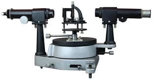

Please note that I want to conduct this experiment in my school laboratory. So, I don't have very good instruments other than a simple student spectrometer, which is used to determine the angle of prism and it's minimum deviation. It is for the use of this spectrometer that the school lab has a Sodium vapour lamp.

Well then, use a lens and examine the spectrum that the prism gives you. Your alternative prism system needs more that just a prism. You will need a well collimated beam and a very thin slit. You say that your spectrometer is perhaps not good. Have you set it up correctly yet? Could se have a photo of it, perhaps? Is it more of a Spectroscope than a Spectrometer - a small cylindrical, hand held device?
You need to look at Images of Spectrometers. Google Images "spectrometer" to see dozens of suitable pictures and links to give you ideas.

I've posted a picture above. Posting it again:
Although this is not the actual photo of the instrument, the one in my school is of this type.

Sorry - I missed the picture lat time round.
So what is wrong with your school model? It may have been mis-used and set up wrongly. I really question whether you will be able to do better. I do remember seeing Sodium D lines when I was at school, on an ancient brass job. The Physics teacher knew what he was doing, though (we had no idea!) and had obviously set it up. Check the slit and the focussing at both ends. I haven't looked but I would be surprised if you cannot find "setting up a spectrometer" somewhere with Google. Imo, that's the best way to go initially. You could well be pleasantly surprised. AND - you wouldn't;t have to actually make anything.
PS What is the prism like that's in the spectrometer already?

The teachers at my school have know idea about this experiment. I'm trying to design it myself. The spectrometer is just kept for show. But it works. The prism is an equilateral glass one. Could you tell me a bit more about the procedure of the lens and the resolution things... I know how to set the instrument, but tell me a bit more clearly about the resolution you were taking of.

You will have a hard job doing better than the instrument you already have - seriously.
I suggested that you search with Google for some instructions. I think you are as capable as I am of doing that and the exercise would do you good. You need to become a bit of a minor 'expert' about this so you have to do a fair bit of reading round and teaching yourself to Search for Information. You should look at a good selection of Google hits and you may have to look way down the list before you find something suitable.
"Collimating a Spectrometer" could be another suitable search term.
