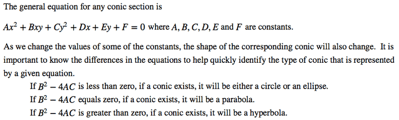

Given an equation, we can determine which type of conic section it describes by calculating ##d=B^2-4AC## (see attachment). However, the theorem demands that the equation describes a conic section. So how do we show that it does?
Does there exist a counterexample where ##B^2-4AC<0##, but it is neither a circle or an ellipse?
Text on the general conic section equation Ax² + Bxy + Cy² + Dx + Ey + F = 0, with the discriminant B² − 4AC classifying it as an ellipse or circle, parabola, or hyperbola.
EDIT: I found that if ##d<0## there is no need to check that a conic section exists because ##d<0## implies a conic section exists.
But it remains to find out whether there is a need to check if a conic section exists when ##d=0## or ##d>0##, given that ##B\neq0##.

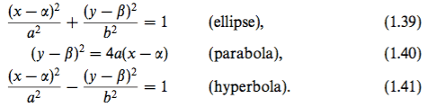

They are defined by their standard representations:
Three standard conic section equations numbered 1.39 to 1.41: ellipse (x-α)²/a² + (y-β)²/b² = 1, parabola (y-β)² = 4a(x-α), and hyperbola (x-α)²/a² - (y-β)²/b² = 1.
from which we could generalise the equations by replacing ##x## by ##x'\cos\theta-y'\sin\theta## and replacing ##y## by ##x'\sin\theta+y'\cos\theta##, which corresponds to a rotation of the OXY coordinate system by ##\theta## clockwise to give the OX'Y' system. It remains to show that the equation ##Ax^2 + Bxy + Cy^2 + Dx + Ey + F=0## can always be written as one of these generalised equations.
Equivalently, we could define them geometrically: they are the loci of a point whose distance from a given point (the focus) is a fraction ##e## (eccentricity) of its distance from a line (the directrix).

OK nice. And indeed, we can bring back any equation of the form ##Ax^2 + Bxy + Cy^2 + Dx + Ey +F=0## to one of those standard representations. Have you see matrix diagonalization??

This has been interesting ... I've been thinking some more about the original question in post #1:
In the graphic/attachment, there is a section from some notes or something where the author keeps saying "if the conic exists".
I suspect this is the source of the confusion.
Normally, if it can be written in the standard form for a conic section, then it is a conic section: pretty much by definition.
Since the author starts out by assuming the standard form, it is unclear what they mean by "if it exists". It must exist: you already have the standard form.

Usually the author of a textbook will make a statement about existence earlier in the text, passages like this are referring back.
Where did you get the excerpt from?
Wow, many errors on that page. Saying a circle is a different type than an ellipse is particularly inexcusable.

@Happiness
I can't tell from that what the author means by "if [the conic] exists"... probably just a bit of nonsense.
I'd suggest trying a number of other sources ... comparing sources is a big part of science literacy anyway.
