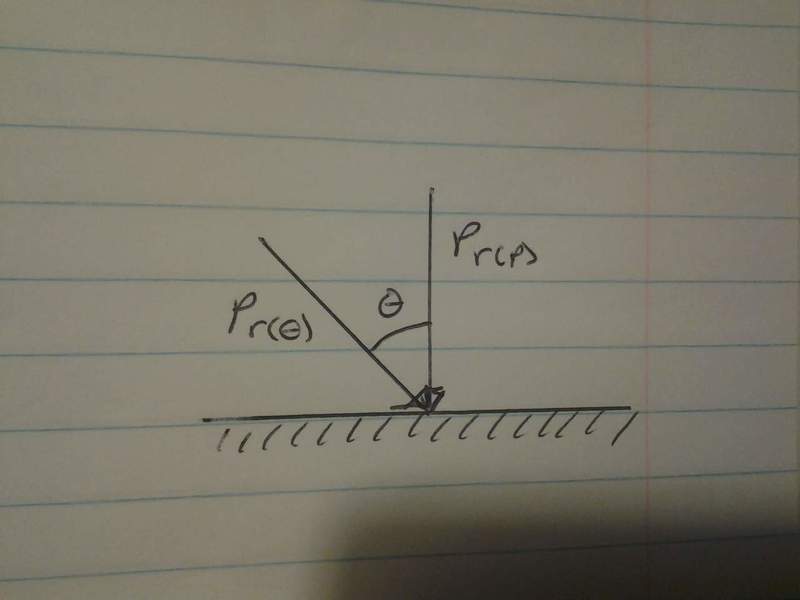

A laser beam of intensity I reflects from a flat, totally reflecting surface of area A whose normal makes an angle θ with the direction of the beam. Write an expression for the radiation pressure Pr[θ] exerted on the surface, in terms of the pressure Pr[p] that would be exerted if the beam were perpendicular to the surface.
Radiation Pressure equation for total reflection back along the original path.
Pr[p] = 2*I/c
See attached picture.
Assuming F[θ] = F[p] = I*A / c
Use geometry to find F[θ]y
F[θ]y = Cos(θ) * F[θ]
Divide the equation by A to find pressure:
Pr[θ]y = Cos(θ) * Pr[θ]
Assuming Pr[θ] = Pr[p]
Pr[θ]y = Cos(θ) * Pr[p]
Since the beam is totally reflected, multiply by 2,
Pr[θ]y = 2 * Cos(θ) * Pr[p]
The correct answer is (Cos(θ))^2*Pr[p]
I'm really lost. I don't know how the cos function gets squared. Please help. Thanks in advance, MrMoose
  • Hand-drawn diagram of a beam reflecting off a flat surface: incoming ray along a vertical normal line, reflected ray at angle θ from the normal, labelled Pr(θ) on the reflected ray and Pr(p) on the normal, with θ marked between them.
Because the plate is angled away from the light, it intercepts fewer light rays than when it is head-on.

The area of the plate is fixed. As the beam is tilted away from the normal, the cross sectional area of the beam that hits the plate reduces. So the intensity of the beam on the plate reduces. At the same time, the radiation pressure per unit of intensity reduces because the momentum is not completely reversed. Both reductions are as cos theta.
