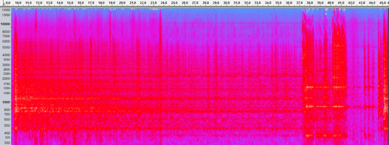

For what it's worth here is a spectrogram of the first spin in the video.
I can't make out any useful change of pattern.
(Generated using the freeware Audacity.)
(Generated using the freeware Audacity.)View attachment 93313
The frequency scale on the attachment seems to have a lower limit of 300Hz (?- there are no labels on the axes so I may be making assumptions). The frequency range, relating to the speed of the ball would be around 10Hz (the rate it hits the sides of the dents on the wheel. Can you change the frequency range on the software to include the appropriate frequency?
Of course, there is the other issue of finding the actual speed of rotation of the wheel . . . . Analysis of the sound will only give the relative speeds.

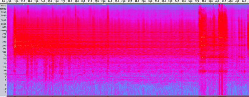

Sorry, I should have said the vertical scale is Hz and the horizontal scale is seconds.
Here's one which goes down 1 Hz, with a 16384-point Hanning window. (I tried other window sizes and types, but none seemed to reveal more detail. It's difficult to find the right trade-off between time-resolution and frequency-resolution.) The sampling rate is 48 kHz.
Is it my imagination, or is there something dropping from about 7 Hz to 4 Hz and then vanishing at 32 s?
We must bear in mind the sound has come from a youtube video and has therefore been subject to lossy compression. Some of the mush may be compression artefacts.
I think you could be right about the low frequency bits. There seem to be three definite horizontals (5,7,and 9 Hz ish). I wonder what the three of them mean. Plus there are a number of horizontals at higher frequencies. Your guess is as good as mine.
The "lossy compression" will certainly have done its bit to spoil those lf components. You don't hear them so compression won't look after them and they could even be non linear products.
It would be interesting to see what the same software makes of the original data.
