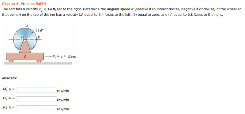

The cart has a velocity vc = 3.4 ft/sec to the right. Determine the angular speed N (positive if counterclockwise, negative if clockwise) of the wheel so that point A on the top of the rim has a velocity (a) equal to 3.4 ft/sec to the left, (b) equal to zero, and (c) equal to 6.8 ft/sec to the right.
I have attached an image of the question
vA = vO + vA/O
vO = -3.4i
v = wXr
r = 11.6j
For part a)
-3.4i = 3.4i + wX<11.6j>
Solving for w gives me
w = 6.8/11.6 k rad/sec
Which is equivalent to
w = 5.597 rev/min
I don't think this is right and I can't see what's wrong with what I've done.
Advice would be greatly appreciated.
  • Diagram of a wheel of radius 11.6 inches resting on a cart labeled C moving right at vC = 3.4 ft/sec, with points O at the center, A at the top of the rim and B on the right side.
Nevermind, I found my mistake. I forgot to convert the 11.6" to feet.
