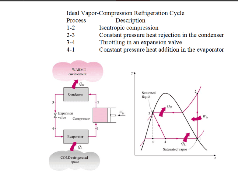

In an ideal refrigeration cycle, the temperature of the condensing vapour is 40oC and the temperature during evaporation is -20oC. Determine the coefficient of performance of this cycle for the working fluids; R12 and ammonia.
C.O.Pc = TL/(TH-TL)
C.O.Pc= ((-20+273)/(40--20))
= 4.2
I don't understand how the working fluid would affect the results of the C.O.Pc (where c stands for carnot efficiency)

From the second attachment I concluded that COPR=(h1-h4)/(h2-h1) so I was able to get h1 from the tables at -20οC. for R12 h1=178.73 and similarly I got h2=74.59. However,I don't know the temperature at 3 or 4 so I can't get h4. What should I do?

The temperature at 4 is going to be the same TL as in the ideal Carnot cycle.
Do like Jim suggests, and look at the worked example he attached in Post #2.

1. Go back to original question
Ideal cycle, eh ?
That's what is represented in the T-S diagram above,
Think about it
working fluid enters evaporator as liquid-vapor mix at saturation pressure and leaves as saturated vapor at same pressure, as stated by phrase "4-1 constant pressure heat addition" and as shown by proximity to saturation line on the T-S diagram ...
that sounds to me like constant temperature
What do you think from looking at the chart ?
in their ideal cycle chart they don't show any superheat so i'd assume saturation temperature on both ends of the evaporator, just different quality.
Isn't that what is the "x" is here , fraction of vapor ?
2. so i think if you know t at 1 you know t at 4. What do you think ?

3. so - what goes on in the condenser ? Heat of vaporization is rejected...
First it cools the superheated compressor discharge , point 2 to saturation line,
then it rejects heat of vaporization at constant pressure again as stated, that's saturation line to other side of saturation curve point 3. Between the two sides of the saturation line it is just giving up heat of vaporization, and that has to be at saturation temperature... I think you probably know T at 3...
