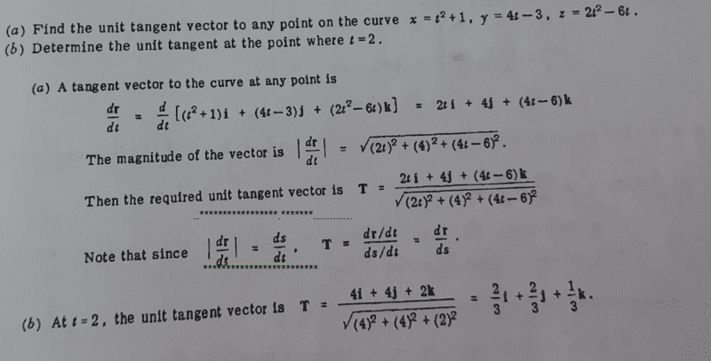

Determine the unit tangent vector

see attached
vector differentiation
Handwritten solution finding the unit tangent vector of r(t) = (t^2+1)i + (4t-3)j + (2t^2-6t)k, with dr/dt = 2ti + 4j + (4t-6)k, its magnitude, T = dr/dt divided by |dr/dt|, and part (b) evaluated at t=2 giving (2/3)i + (2/3)j + (1/3)k.
I need a justification that ##|\dfrac {dr}{dt}|##=##\dfrac {ds}{dt}## cheers guys... all the other steps are easy and clear to me...

I need a justification that [Modulus ##\big | \dfrac {dr}{dt} \big |##=##\dfrac {ds}{dt}##] cheers guys... all the other steps are easy and clear to me...
We have ##ds \equiv |d\vec r|##.
Aaaaah Perok cheers!
