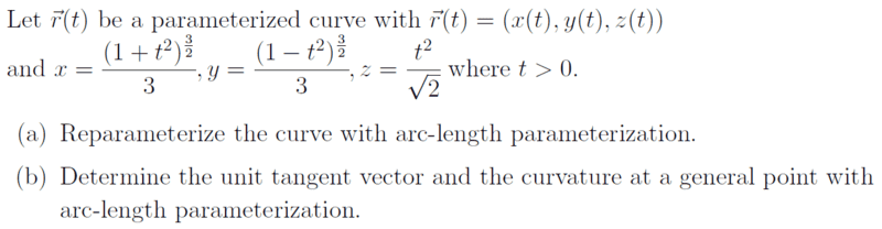

Please see below
ds/dt = |r'(t)|
T(t) = r'(t) / |r'(t)|
K = |dT/ds|
Typeset problem statement: parameterized curve r(t) = (x(t), y(t), z(t)) with x = (1+t^2)^(3/2)/3, y = (1-t^2)^(3/2)/3, z = t^2/sqrt(2), for t > 0; parts (a) reparameterize by arc length and (b) find the unit tangent vector and curvature.
(a)
$$\frac{ds}{dt}=|r'(t)|$$
$$=\sqrt{(x(t))^2+(y(t))^2+(z(t))^2}$$
$$=\frac{2}{9}+\frac{7}{6}t^4$$
$$s=\int_0^t |r'(a)|da=\frac{2}{9}t+\frac{7}{30}t^5$$
Then I think I need to rearrange the equation so ##t## is the subject, but how?
Thanks
Edit: wait, I realize my mistake. Let me redo
I think I can do (a). I got ##s=t^2##
For (b), I just want to ask about the correct approach. I think I need to use the chain rule to find r'(t) so ##r'(t)=\frac{dr}{ds}\times \frac{ds}{dt}##
Am I correct? Thanks
