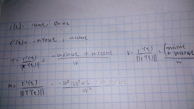

Ok, here is after correction

So far
we have ##\vec r\qquad##
don't forget the arrow over the ##r## -- or some other way to clearly mark it as a vector
don't forget the brackets
##\qquad \vec r(t) = (cos\omega t,\sin\omega t)\ \ ## which was the given data.​
we have ##\vec r'\qquad ## which is ##\vec v## (so ##\vec v## is NOT your ## {r'\over|r'|} ## !)
don't forget the arrow over the ##r'## -- or some other way to clearly mark it as a vector
##\qquad \vec r'(t) = (- \omega \sin\omega t,\omega\cos\omega t)\ \ = \omega (\sin\omega t,\cos\omega t)\ \ ## .​
We see that ##|\vec r| = 1 ## (right ?) and we see that ##|\vec r'| = |\omega| ## (right ?)
But then you go all wrong by thinking that ##\vec T## is not a vector.
And what you do to find ##\vec N## is a mystery to me. Again, you write it as a number, which it is NOT. ##\vec N## is a vector !

sorry , for T , it should be (-w sin wt i + w coswt j ) / w
, similarly ,
for N , it should be = (-(w^2)((coswt)^2) i - (w^2)((sinwt)^2) j ) / (w^2)

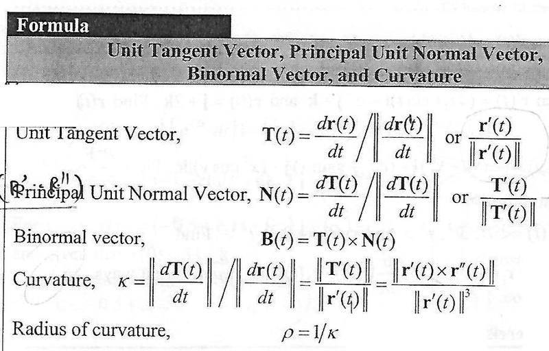

Again , here's the formula have in my book

Do you know how to calculate the norm of a vector product such as ##\ \vec r'\times \vec r'' \ ##?
do you mean express it in form of unit vector ?
why not answer a question with an answer instead of with a question :smile: ?
To your question: No. Unit vectors are boring :smile: : they have norm 1.
In this case you are (of course :rolleyes:) not interested in the vector itself (*), but in the length of that vector product. That is ##\kappa##, a number.
(*) but you can ask yourself which way it is pointing, e.g. for a particle in a circular trajectory in the plane...

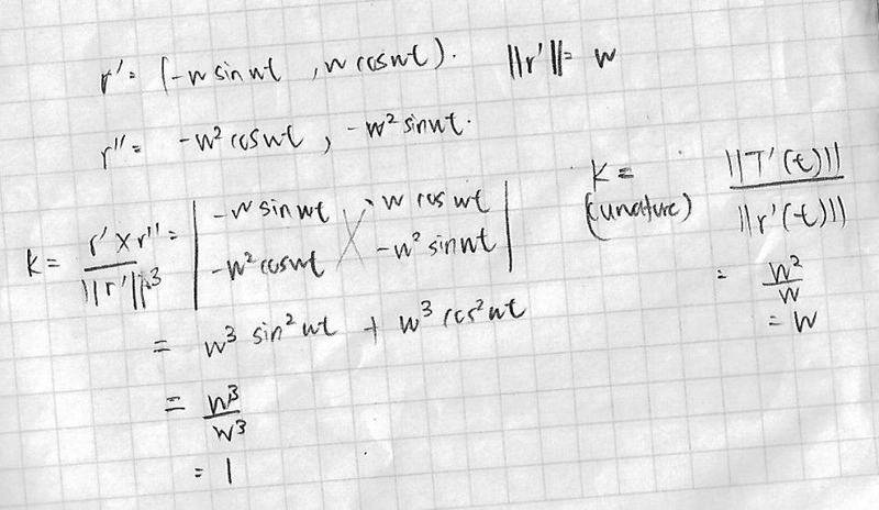

well, here's my working...I didnt get the same ans though, which part of working is wrong?
i get w and 1 respectively when i used different approach...

A unit circle has a radius 1, so my guess is that the answer 1 is correct and the answer ##|\vec \omega|## is wrong. And I've found why and it's somewhat my fault because in post #72 I made two huge mistakes.
Note that we are doing two things in parallel: working out the simple example ##\vec r = (cos\omega t, \sin\omega t)## and make an inroad for your long-standing question as in post #1, #13 and #63.
I humbly fix #72:
So far we have the unit vectors (:smile:) ##\ \ \vec T = (-\sin \omega t,\cos\omega t)\ \ ## and ##\ \ \vec N = -\vec r\ \ ## Curvature is 1 and radius is 1.

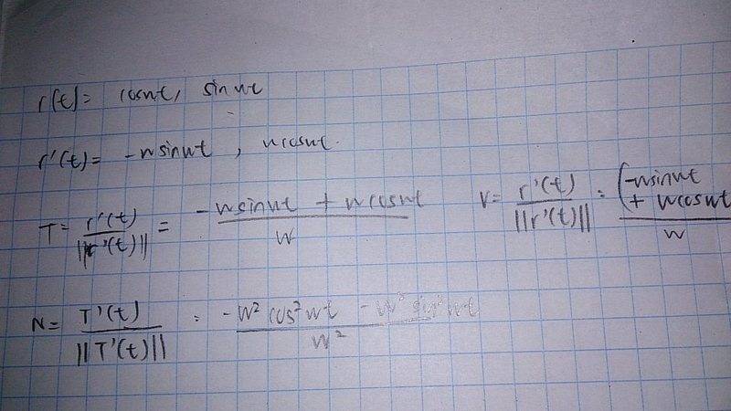

Here's my previous working
In your working (I had seen it and checked it already) in the expression for ##\vec T## you can divide out the ##\omega## in the numerator against the ##\omega## in the denominator. (That way you also get a vector that clearly has length 1). Differentiate wrt time to get ##\vec T' = -\omega \;(\cos\omega t, \sin\omega t)## ...
The expression for ##\vec T## in your working may be right (apart from the incorrect notation), but
you should still correct your expression for ##\vec N##: it is not correct.

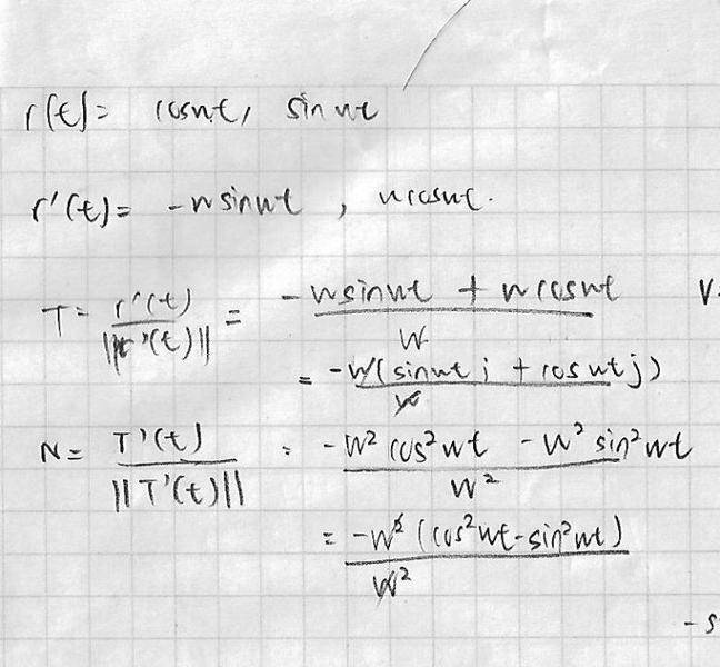

chetzread said:
do you mean by cancelling off the w in the denominator and numerator ##\vec T##
yes
and cancelling off (w^2) in the denominator and numerator ##\vec T'##
No. You differentiate wrt time . See post #83.
eventually, we get magnitude of ##\vec T## and ##\vec T'## equal to 1? k =1 ?
Yes for ##|\vec T|##, beccause ##\vec T## is a unit vector.
No for ##|\vec T'|## because ##\vec T'## is NOT a unit vector. (but of course ##\vec N \equiv \vec T'/|\vec T'|## IS a unit vector !)
