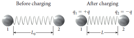

Two initially uncharged identical metal spheres, 1 and 2, are connected by an insulating spring (unstretched length L0 = 1.55 m, spring constant k = 30.0 N/m), as shown in the figure.
Charges +q and –q are then placed on the spheres, and the spring contracts to length L = 1.250 m. Recall that the force exerted by a spring is Fs = kΔx, where Δx is the change in the spring's length from its equilibrium length. {Correct Answer: a. 3.96e-05 C, b. 1.55 m}
(a) Determine the charge q. (b) If the spring is coated with metal to make it conducting, what is the new length of the spring?
