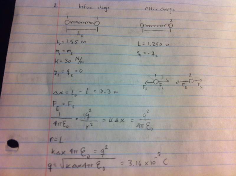

Two initially uncharged identical metal spheres, 1 and 2, are connected by an insulating spring (unstreched length L0 = 1.55 m, spring constant k=30.0 N/m).
Charges +q and -q are then placed on the spheres and the spring contracts to length L = 1.25 m.
a. Determine the charge q.
b. If the spring is coated with metal to make it conducting, what is the new length of the spring?
Fs = -kΔx
Fe = 1 / 4∏ε0 * (+q)(-q) / r^2
m1 = m2
I attached my work.
for a. what I basically did was set Fe = Fs and solved for q.
I got 3.16*10^-5 C, but the answer should be 3.96*10^-5 C. Could it be because of truncated significant figures?
for b. How can I show that coating the spring in metal cause the metal ball to return to L0?

You dropped r^2.
1.25^2 * your result is what you want?
