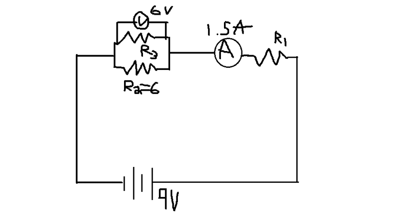

doublea500
Question asks for a lot of stuff...
Total Resistance
Total Current
R1, V1 <
V2, I2 <----- R=resistance V=Voltage I= Current 1 is resistor 1, 2 is res2...
R3, I3 <
V=IR
Kirchoffs loop rule
Well I am completely lost because i don't know a few things.
well to start it off, I am going to have to use the loop rule. here's my few questions before i actually start it. Where it says the 1.5A after R1, does that show that the amplitude for R1 is 1.5 or the amplitude for the parallel circuit after it is 1.5A. for the V on the top, how do i know which is positive and which is negative (doesnt have long and short lines). and with the 9v battery, it has 2 sets of small lines and big lines. does this mean anything or is it just left is - and right is +?

Firstly, with the battery the smaller line (on the left) is negative, the other is positive. You should be able to work out which side of the V is negative and which is positive from that. The A is just showing that there is 1.5amps flowing through the circuit at that point. That's the best i can do for now so if anyone else has more detail, please add.
like what I am trying to ask is if you do V=IR would it be 9V=1.5A*R1 and then you could find r1 like that?
