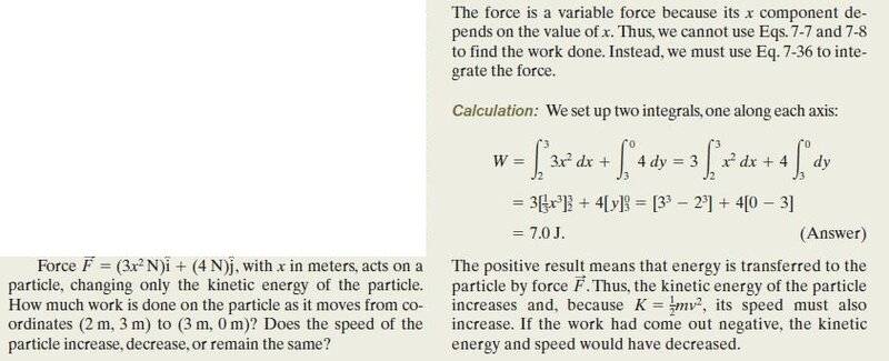

I probably didn't explain it well. Apologies for the poorly-edited image above, but that is the problem I am referring to. It starts out with an i and j direction for the forces, but then after integrating, everything just gets merged together as a single scalar value.
On this problem, initially before seeing their answer, I took the answer I got from the i direction (19), and the answer I got from the j direction (-12), and thought to find the magnitude of the force, take:
sqrt (19^2 + (-12)^2) = 22.5J
Hopefully, that makes more sense of my thought process and where I'm a bit confused as to why i and j disappear, and they are added together regardless of direction.
Work done is a line integral; the result is a scalar. In general it is [tex] W = \int_0^S \mathbf{F}(\mathbf{x}(s)) \cdot \mathbf{x}'(s)\,ds[/tex] where [itex]s[/itex] is a parameter along the path (which need not be equal to time [itex]t[/itex]). Here the force is conservative so the result is independent of the path taken between the initial and final positions, and the text has implicitly taken [tex]\begin{split}<br /> \mathbf{x}(s) &= \begin{cases}<br /> (2 + 2s)\mathbf{i} + 3\mathbf{j} & 0 \leq s \leq \frac 12 \\<br /> 3\mathbf{i} + (6 - 6s)\mathbf{j} & \frac12 < s \leq 1\end{cases} \\<br /> \mathbf{x}'(s) &= \begin{cases}<br /> 2\mathbf{i} & 0 \leq s \leq \frac12 \\ -6\mathbf{j} & \frac12 < s \leq 1. \end{cases} \end{split}[/tex] Thus only the [itex]\mathbf{i}[/itex] component appears in the integral over [itex]0 \leq s \leq \frac12[/itex] (and we can make the substitution [itex]x = 2(1 + s)[/itex]) and only the [itex]\mathbf{j}[/itex] component appears in the integral over [itex]\frac12 \leq s \leq 1[/itex] (and we can make the substitution [itex]y = 6(1 - s)[/itex]), resulting in the calculation given in the text.

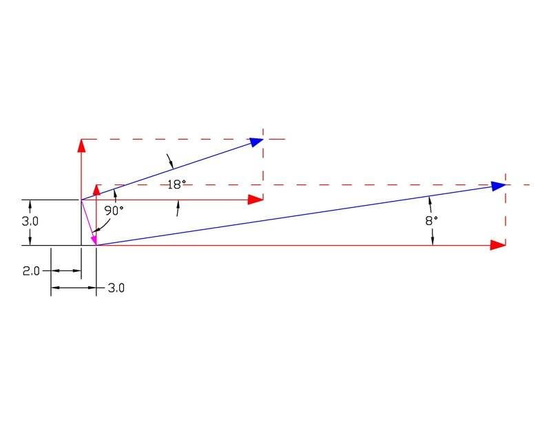

As described in the problem, we start with two orthogonal components (12 N and 4 N) of a force vector, which has magnitude 12.65 N and direction 18° from horizontal.
That is the actual initial force acting on the particle.
At the time when the trajectory ends, we have two orthogonal components (27 N and 4 N) of a new force vector, 27.3 N and which has magnitude 12.65 N and direction 8° from horizontal.
That is the actual final force acting on the particle.
That force, that is constantly increasing in magnitude and rotating clockwise, is the one doing the work of increasing the kinetic energy of the particle.
Within that range, any individual force vector that we choose will give us an incorrect result.
Note how the second member of the equation is negative because the 4 N j component of the forces points in opposite direction to the displacement of the particle.
The particle is forced to move in that direction by the component (in the direction of the trajectory) of the increasing and rotating actual force.
