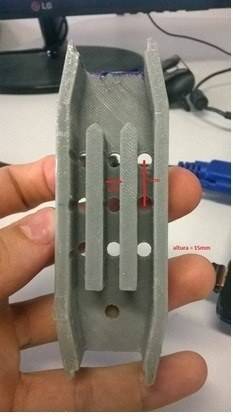

I'm working in a project of a company to develop a flow meter using a microcontroller and Infrared sensors.
I'm stuck in the mechanic fluid part.
We're trying to develop this product basing in the mechanic model of the attached picture.
The liquid will enter in the top and pairs of IR leds and Phototransistors and the A/D converter of the microcontroller will read the voltage oscillation caused by the difference of the density of the liquid.
The liquid will pass with pulsating vacuum.
The goal of the 3 channels is to segment the liquid and increase the precision of the read.
I'm having sobre problems with the voltage read and I'm starting to think that this problems are related with fluid mechanics like turbulent flow.
We're developing this mechanics prototypes using a 3-D Printer.
My goal is to develop a mechanic prototype that will segment the liquid with no turbulent flow (or less tuebulent possible).
I don't know much about fluid mechanic, but I studied a little bit about Reynold Number and turbulent flow.
If someone could help I would be grateful.
Thanks and sorry for the bad english.
  • Photo of a grey 3D-printed flow channel held in a hand, with three vertical dividers and small circular holes, a red-marked dimension and the note "altura = 15mm".
The squared off ends of the two segments bounding the center stream are going to cause turbulence (be they upstream or downstream).
Hi Bystander, thanks for the answer.
That's a great hint. Thanks. I'll tell to the Solidwork guy of the company to put a softly format in the end of the channel for testing.
If you have more advices I'll be very grateful.
As I said before, I have little or nothing experience with fluid mechanics.
Thanks.

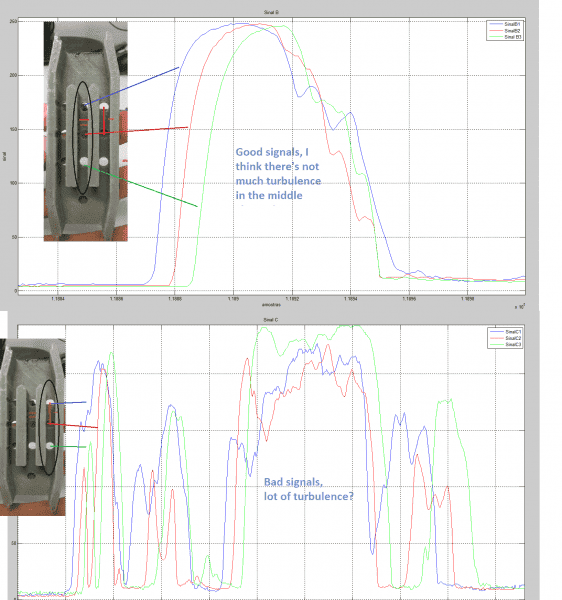

I'm posting a picture with the plot of the values of the middle channel and the right channel.
Two stacked plots of signal amplitude against time from three sensors, each with a photo of a flow channel with sensor positions marked by coloured arrows. Top plot shows a clean pulse; bottom plot shows noisy, multi-peaked signals.
I don't know if my assumptions are right, but I think that something like that.
