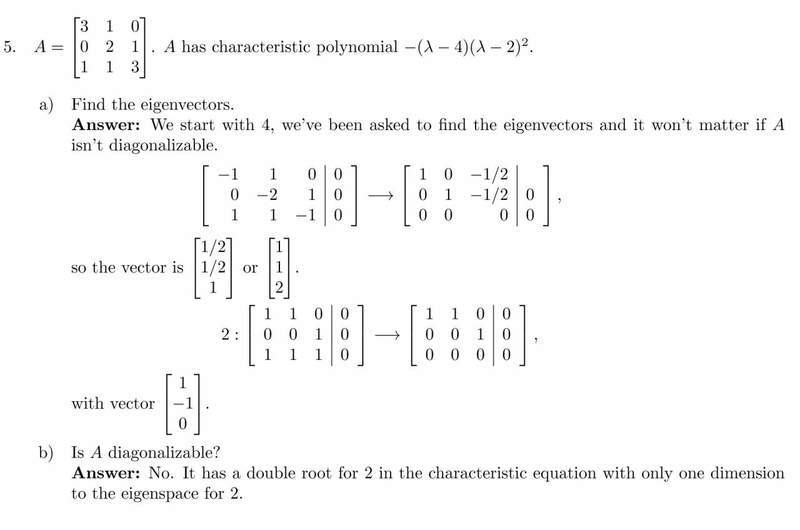

I think my teacher made a mistake in his homework answer. I need to verify this for practice. The answer I got is below. The answer the teacher has is in the pdf.
Please refer to attached pdf
So there is two eigenvalues= 4 and 2
but the eigenvalue 2 has 2 eigenvectors [-1 1 0]T and [0 0 1]T but my teacher has only one [-1 1 0]T. That's why he says A is not diagonalizable. Do you think it's correct?

I get the same result as your teacher for [tex]\lambda = 2[/tex]
[tex]A= \begin{bmatrix}<br /> 3 & 1 & 0\\ <br /> 0 & 2 & 1\\ <br /> 1 & 1 & 3<br /> \end{bmatrix}[/tex]
so for lamda = 2,
[tex](A-2I)\vec{v}=\vec{0}[/tex]
[tex]\begin{bmatrix}<br /> 1 & 1 & 0\\ <br /> 0 & 0 & 1\\ <br /> 1 & 1 & 1<br /> \end{bmatrix}<br /> \begin{bmatrix}<br /> v_1\\ <br /> v_2\\ <br /> v_3<br /> \end{bmatrix}<br /> = \begin{bmatrix}<br /> 0\\<br /> 0\\<br /> 0\\<br /> \end{bmatrix}[/tex]
I've personally always found it easier to not do row operations here and just jump straight in. From that you get
[tex]v_3 = 0[/tex] and [tex]v_1 = -v_2[/tex]
so therefore [tex]\vec{v} = \begin{bmatrix}<br /> 1\\ <br /> -1\\ <br /> 0<br /> \end{bmatrix}[/tex]
Since it is a 3x3 matrix, it needs 3 eigenvectors to be diagonalizable.
Hope this helps.
Hi, thanks for replying. Attached is how I got my vectors, do you think my steps are correct.
No. Why do you think (0, 0, 1) is an eigenvector? You seem to just pull that out of thin air.
You seem to have made a mistake in the step
Why is your second row 1 0 1 instead of 0 0 1 ?
Have you said [tex]v_2= \delta[/tex] ? I'm not sure if I have read that correctly. If it is a delta, you can't say that unless the whole row equals zero. i.e.
[tex]\begin{bmatrix}<br /> 0 & 0 & 0<br /> \end{bmatrix}<br /> \begin{bmatrix}<br /> v_1<br /> \end{bmatrix}<br /> = \begin{bmatrix}<br /> 0<br /> \end{bmatrix}[/tex]
