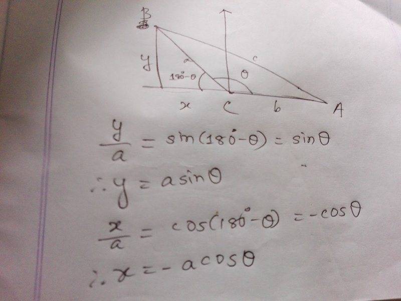

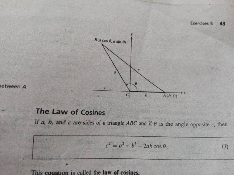

In the attached pic,it is shown that the coordinates of point B are (a cos theta, a sin theta) ,but shouldn't it be (-a cos theta,a sin theta)? Can anybody please help?

No there is nothing wrong with the labeling of the coordinates in the diagram. Recall that ##\cos \theta## is negative for ##\pi/2 < \theta < 3\pi/2## (or what you may know as the second and third quadrants).
But didn't it come like this?(see the attachment)
When you did the triangle construction in your diagram, you treated ##x## there as a length, which only takes on positive values, but ignored its position relative to where the origin was defined. So, the x-coordinate of the point should in fact be the negative of the ##x## in your derivation.
Oh,now I got it,thank you so much:smile:
