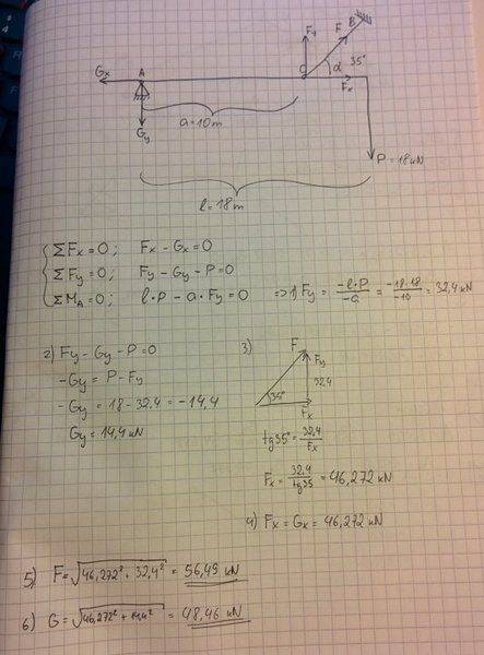

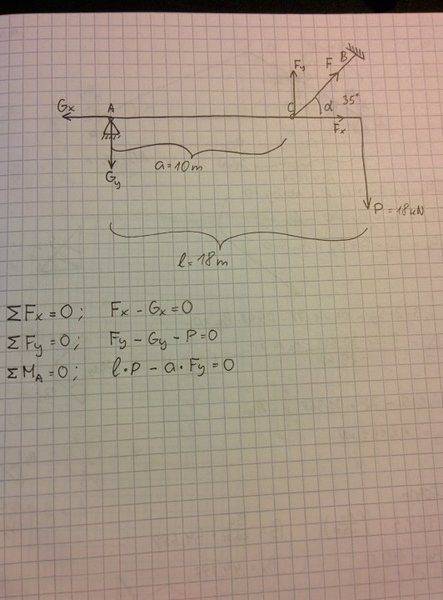

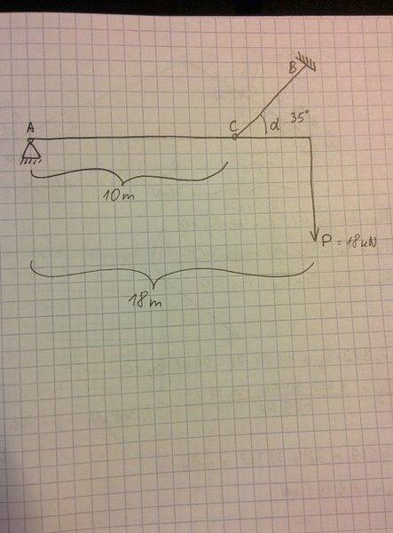

Given:
a=10m
l=18m
P=18kN
angle alpha = 35 deg
The task is to calculate the base reaction forces on A and on B
This is my attempt on creating the balance equation system.[/B]
When replacing the variables with numbers, and trying to solve the equations, I get , in my opinion , unrealistic answers.
Is there any mistake this far?

No.
Chestermiller said:
No.
So this is correct as well?
I guess I found my mistake.
rihitz said:
View attachment 106651 So this is correct as well?
Maybe you want to mark the thread Solved.
