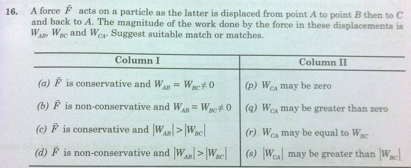

Printed physics problem 16 with a two-column matching table: Column I lists conservative and non-conservative force conditions (a) to (d) on work W_AB, W_BC and W_CA; Column II gives statements (p) to (s) about W_CA.
W=-ΔU for conservative force.
Let all three forces be conservative.
Since particle comes back to where it was, ΔU=0.
Hence ΔUAB+ΔUBC+ΔUCA=0
Hence WCA=-WAB-WBC
For case A, if both WAB, WBC>0, then WCA<0. Else its greater than zero. It is not possible for WCA=WBC because it will contradict the given statement. (Let WAB=WBC=x and other be equal to y. Then 2x=y and x=y which is not possible).
Hence for A: q,s.
Given answer: q,s
Moving onto case C, again q is true. But r can't be true since they have opposite signs. s can also be true.
Hence for C: q,s
Given answer: q,r,s
Are they considering only the magnitude?

Titan97 said:
How do I approach case B and D?
I don't understand how in case B ,the given condition is satisfying q ?
For case B and D, apply W=ΔKE. The particle can be moved such that kinetic energy may not change.
All answers p,q,r,s satisfy B and D.
Hence
A: q,s
B: p,q,r,s
C: q,r,s
D: p,q,r,s
