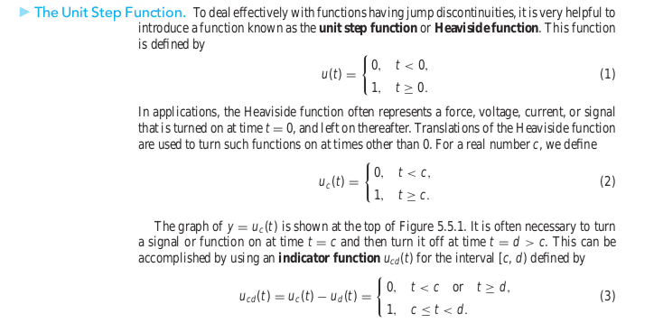

We aren't mind readers here. What is ## u_{k\pi}(t)##? And what do you get for the transform of the right side?
I'm sorry, I thought it was common notation that [itex]u_{k\pi}(t)[/itex] is the indicator function denoting the unit step function:
[tex]u_{k\pi}(t)=u_{k}(t)-u_{\pi}(t)=\begin{cases}<br /> 0, & t<k\quad\text{or}\quad t\ge\pi\\<br /> 1, & k\le t<\pi<br /> \end{cases}[/tex]
As for what I got for the Laplace transform of the right, it is:
[tex] \frac{1}{s}+2\sum_{k=1}^{n}(-1)^{k}\cdot\frac{e^{-ks}-e^{-\pi s}}{s}[/tex]

For example, if ##k=5## your definition says ##u_{5\pi} = 0\hbox{ if } t<5\hbox{ or }t>\pi##, which is identically zero. Same for any ##k\ge 4##. Something looks fishy to me.
Courtesy of Brannan,
Textbook page on the unit step function: definitions of u(t) and u_c(t) as piecewise functions (0 for t < c, 1 for t >= c), and the indicator function u_cd(t) = u_c(t) - u_d(t) with its piecewise definition.
The only other possibility is that [itex]c=k\pi[/itex].
Edit: Yes I think that's actually the problem faced here.. I believe it works if I let
[tex]u_{k\pi}(t)=u(t-k\pi)[/tex]

It shows what a horrible notation that subscripted u is. If you just write u(t-c) when you want it, there is no ambiguity. So apparently you are saying your equation is$$
y''+0.1y'+y=1+2\sum_{k=1}^{n}(-1)^{k}u(t-k\pi)$$Is that correct? And when you say "it works", do you mean you see how to finish the question?
Yes, that subscript notation is definitely horrible as it caused me a lot of grief haha.
And yes, by "it works" I meant I solved the DE resulting in the solution of,
[tex] y(t)=h(t)+2\sum_{k=1}^{n}(-1)^{k}h(t-k\pi)[/tex]
where
[tex] h(t)=1-e^{-0.05t}\cos(\sqrt{0.9975}t)-\frac{0.05e^{-0.05t}}{\sqrt{0.9975}}\sin(\sqrt{0.9975}t)[/tex]
Thanks for the 'indirect' help!
