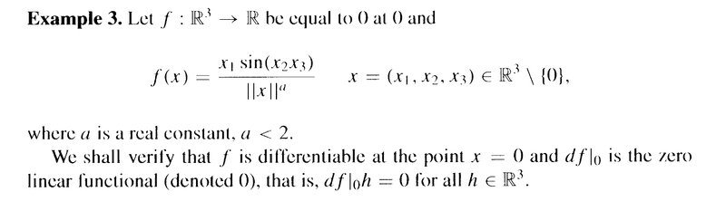

I need help with an aspect of Kantorovitz's Example 3 on pages 65-66 ...
Kantorovitz's Example 3 on pages 65-66 reads as follows:
Printed textbook page showing Example 3: f: R^3 to R with f(0)=0, f(x) = x1 sin(x2x3)/||x||^a for x nonzero, a a real constant less than 2, followed by text on verifying differentiability at 0 with zero differential.
Typeset proof text showing that |phi_0(h)|/||h|| = |h1 sin(h2 h3)|/||h||^(a+1) is bounded by ||h||^(2-a), which tends to 0 as h approaches 0 since a < 2, so df at 0 is zero.
In the above example, we read the following:"... ... ##\frac{ \mid \phi_0 (h) \mid }{ \| h \| } = \frac{ \mid h_1 \text{ sin } (h_2 h_3) \mid }{ \| h \|^{ a + 1 } }## ... ... ... "

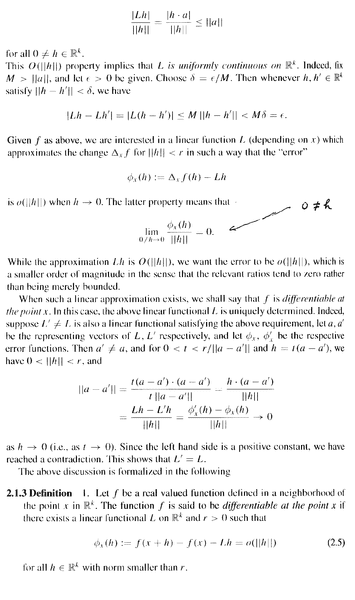

My question is as follows:In the Section on The Differential (see scanned text below) ...

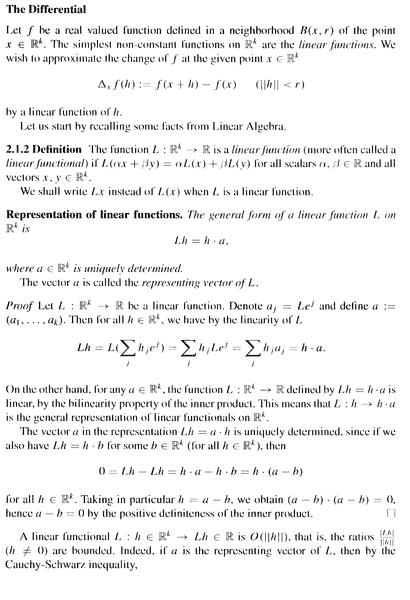

Kantorovitz defines ##\phi_x(h)## as follows:
##\phi_x(h) := f(x +h) - f(x) - Lh##
so that
##\phi_0(h) := f(0 +h) - f(0 ) - Lh = f(h) - f(0)## ...... BUT in the Example ... as I understand it ... ##f(0)## does not exist for the function in Example 3 ...? ...
... BUT ... Kantorovitz effectively gives ##\mid \phi_0 (h) \mid = \frac{ \mid h_1 \text{ sin } (h_2 h_3) \mid }{ \| h \| }##
Can someone please explain how Kantorovitz gets this value for ##\mid \phi_0 (h) \mid## when ##f(0)## does not exist?Help will be much appreciated ...

Readers of the above post may be helped by having access to Kantorovitz' Section on "The Differential" ... so I am providing the same ... as follows:

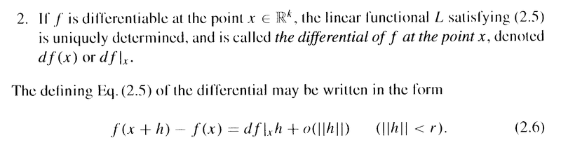

Printed textbook page: item 2 states that if f is differentiable at x in R^k, the linear functional L satisfying (2.5) is unique and called the differential of f at x, denoted df(x) or df|_x; Eq. (2.6): f(x+h) - f(x) = df|_x h + o(||h||) for ||h|| < r.

I've just noticed that the author defines the function to be zero at zero!
:frown: ... careless of me to miss that!
My apologies ...
Peter
