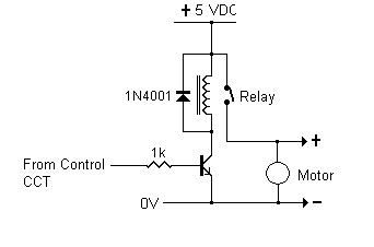

the part being protected could be the output of an IC, opamp or otherwise
or it could be as in my circuit below, a single transistor
CWatters said:
In your relay circuit the high voltage can cause damage. The diode prevents the voltage going very high by limiting it ("clamping it") to around Vd = 0.7V. The diode is sometimes called a clamp diode, a freewheeling diode or a flyback diode...
The way you described that infers that the diode just clamps ( stops) the back EMF. This isn't really what happens.
That energy has to go somewhere and it doesn't/isn't just stopped at the or by the diode.
So, better to look at it that any spike over around 0.7V ( the conduction voltage of the diode) is conducted back through the diode to the positive rail ( the +5V in my circuit above) and away from the transistorDave
