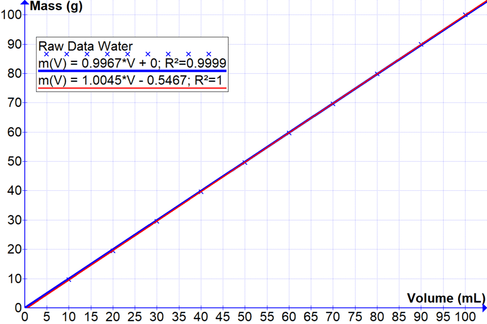

fizzy said:
A graduated cylinder which is not cylindrical to within the indicated precision seems a little unlikely. It seems far more likely that your spurious attempts force the fit through zero was leading to an incorrect regression slope which produced increasing residuals at higher volumes. It is hard to say without seeing the data but it sounds like it did have a finite intercept, but you were in denial about such things, regarding them as "silly".
I expect folks who think it is unlikely for high school lab equipment to not be within its indicated precision have not spent sufficient time with high school lab equipment. I teach students how to check and double check equipment accuracy. What better simple check on the accuracy of a graduated cylinder (accuracy spec 0.2 CC) than an electronic balance (verified accuracy spec 0.01 g)?
Once accepts the constant density of water, one can use the balance itself as the best available check on the accuracy of the graduated cylinder. About half the measurements with the graduated cylinder were outside its spec. This is not a train wreck for how graduated cylinders are usually used in science labs, but I do encourage students to take note of the limitation.
The resulting density of water without a vertical intercept was 0.9967 (g/cc) with an R-Squared of 0.9999. Adding a vertical intercept puts the R-Squared closer to one, but the resulting density of water is 1.0045 g/cc with a vertical intercept suggesting that 0 cc of water has a mass of -0.5467 g. Silly. The known good value for the density of water at 20 deg C is 0.998 g/cc.
fizzy said:
Did you teach your students how to correctly read the meniscus of the fluid in the measuring cylinder?
Yes, of course.
fizzy said:
That could lead to a finite intercept, if you would allow that possibility to be seen. There clearly was some experimental error which needs to be identified. Had you not expressly removed the constant term, it would have given you some information about the problem. You have neatly demonstrated one reason not to bias the regression by excluding parameters.
I only removed the constant term for the student method after my careful pilot experiment. My careful pilot included analysis with several possible models, linear with and without constant term, and quadratic with and without constant term. I also carefully considered the residuals of the different models for three different liquids with known densities: water, isopropanol, and acetone. The high correlations of the residuals for different liquids suggests the most likely source of error was the graduated cylinder itself.
fizzy said:
If you suspected the cylinder was not straight, did you at least measure it to attempt to falsify this hypothesis. Apparently not. Did you substitute another cylinder to test the hypothesis.
And with what instrument commonly found in high school labs would you suggest accurately measuring the inner diameter at the bottom of a graduated cylinder? The other available cylinders were from the same manufacturer and demonstrated the same trend. (Adding apparently equal volumes near the top added more mass on the balance.) But the most convincing evidence was seeing the same trend in two additional liquids (isopropanol and acetone.) I expect as a manufacturing convenience these plastic graduated cylinders are formed on molds that make them slightly narrower at the bottom than at the top so that they are easier to remove from the molds. It is much more cost effective and resistant to breakage than glassware, and adequate for many laboratory purposes if the limitations are understood. If need be, a cylinder could be recalibrated with water, but it is easier just to double check on a balance for liquids of known density.

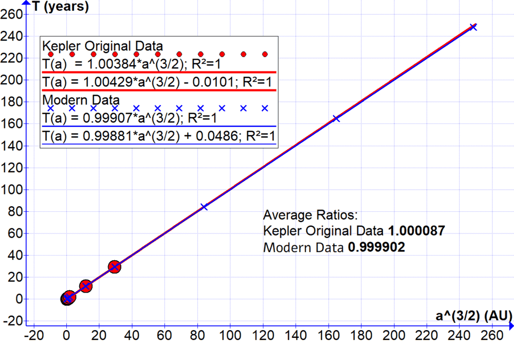

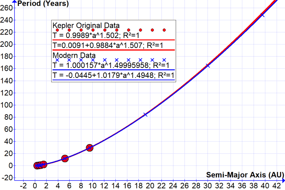

Dr. Courtney said:
Would it make sense to add a vertical offset fitting data to Kepler's Third Law?
Yes, it would. For all of the reasons already identified above.
  • #45
A 'DC' offset would apply to all your measurements. if you were to crowbar your curve fit to a wrong value near the origin, it would result in the parameters of your best fit curve being corrupted. Remember that all your measurements are subject to all the error sources and the curve can't know about the law that you are trying to fit them to. They are telling you there is something wrong by predicting that a low pair of co ordinates wouldn't sit at 0,0. Any 'theory' you try to apply to a set of measurements has to be consistent (within bounds) with your measurements. It would be like saying "These are Keppler's Laws but they don't apply at four o'clock on Sunday afternoon".
Interesting theory, but I was skeptical since forcing the line through the origin has tended to give better agreement with "known good" values over lots and lots of intro physics experiments I've supervised.
So I just completed a numerical experiment. The the Area of a circle (A) vs. the square of the radius is a straight line through the origin with a slope of pi. Adding some Gaussian noise with a defined standard deviation will give values of the slope that differ a bit from pi. If allowing an offset is better, the RMS error of the slope from pi will be SMALLER than the RMS error of the slope without the offset.
I used values of r from 1 to 10 in steps of 1, and standard deviations in the error added to A varying from 0.01 to 1. The RMS errors of the slopes from pi LARGER in every case allowing the offset. For example, for a standard deviation in the error added to A of 0.1, the RMS error in the slope was 0.0015 allowing the offset and 0.00082 forcing the line through the origin. Repeating the numerical experiment with Circumference vs diameter yields the same result that the RMS error of the slope from the known good (pi) is always LARGER when the offset is allowed.
Nice theory, but when the value of the output is known to be zero for zero input, forcing the line through the origin provides a more accurate value of the slope.

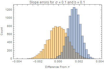

  • #53
Dr. Courtney said:
My experiment showed that the slopes are more accurate - in better agreement with the known good value.
Sure, but your experiment did not address @sophiecentaur's "interesting theory" that you were skeptical about.
So, I did my own numerical experiment which did address the "interesting theory". I did almost the same thing that you did. I simulated 10000 data sets each with r incremented from 1 to 10 in steps of 1, I calculated ##r^2## and ##A_i=\pi r^2+b + \epsilon_i## with the "DC offset" ##b=0.1## and the random noise ##\epsilon_i \sim \mathcal{N}(0,0.1)##, and I did linear fits both with an intercept and without an intercept. I then subtracted ##\pi## from the fitted slope to get the error in the slope and plotted the histograms below. The orange histogram is the error in the slope with the intercept and the blue histogram is the error in the slope without the intercept.
Note that there is substantial bias without the intercept. The no-intercept estimate is slightly more precise (as you discovered), but it is less accurate. The fit with the intercept is unbiased while the no-intercept fit is biased and the overall RMS deviation is greater for the no-intercept model.
The increased precision of the no-intercept estimate is deceptive, it does not generally correspond to increased accuracy as you suggested. Furthermore, because the intercept model is unbiased the correct slope can be obtained simply by acquiring enough data, whereas (even in the limit of infinite data) the no-intercept model will not converge to the correct estimate.
@sophiecentaur 's concern is valid, as shown in a relevant simulation, and is one of the issues recognized and discussed in the literature I cited earlier
Dr. Courtney said:
If the experimental goal is a more accurate determination of the slope, the method works well.
The method is not more accurate in general, particularly not in the actual scenario raised by @sophiecentaur

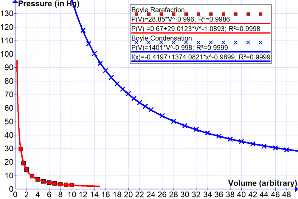

  • #58
sophiecentaur said:
Many people post on PF and imply that they have found holes in accepted science. This seems to be just another example. Rule number one is to doubt yourself before you doubt Science. Only after extended work on a topic can anyone be sure that a change of model is justified.
And yet that is what you suggest for fits to power laws such as Kepler's third law. I have seen many published papers fitting data to power laws, including Kepler's third law. I don't recall any of them adding a third parameter (vertical shift) to their model. Yet you are insisting that a change of model is justified. Change of models is only justified from more accurate results, not theoretical arguments like you and Dale are making.
Consider the graph below showing an analysis of Robert Boyle's original data published in support of Boyle's law. Fitting this data to a traditional power law yields better agreement with the "known good" value for the exponent. Adding a third adjustable parameter (the vertical shift) gives a higher r-squared and a lower Chi-square, but it gives a less accurate value for the exponent in both the condensation and rarefaction cases. I prefer the method that gives an error of 0.004 over the method with an error of 0.089 (Rarefaction case). I prefer the method that gives an error of 0.002 over the method that gives an error of 0.01 (Condensation case).

  • #60
Also consider the inaccuracies in the parameters introduced by adding a vertical shift to the power law as applied to Kepler's Third Law. Adding the vertical shift yields less accurate determinations of both the lead coefficient and the exponent for both the case of Kepler's original data and the modern data. I don't care about theoretical arguments about whether a vertical shift will yield more accurate (or unbiased) parameter values. Forcing the power law model through the origin actually does provide more accurate parameter values.
