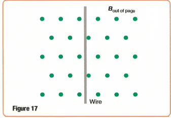

Direction of Electric field (EM induction)
When a wire is pulled to the right, the direction of the electric field within the wire is downward. The confusion arises from whether to consider the moving charges as positive or negative, impacting the current's direction. Electrons, which are the mobile charge carriers, move to the right, while the conventional current direction is considered as if positive charges were moving. It's important to note that without a complete circuit, there is no established current in the wire. Understanding the forces acting on the charges is crucial for analyzing the resulting electric field direction.

In which direction would the electric field in the wire point if the wire were pulled to the right?
Right hand rule
F=qvXB
My answer is downward. I am confused whether I should take the moving charges as positive or negative since this would determine the direction of the current.
I know that the direction of the current is the same as the electric field. (for positive)
Thanks!
Which particles are mobile? Electrons or protons?
Electrons. But we take the convention of moving "positive charges"
There is no "current" in this wire as there is no complete circuit. Protons and electrons both are moving towards right as the wire is dragged. What is the magnitude and direction of the forces acting on both the particles? What will happen because of these forces?
