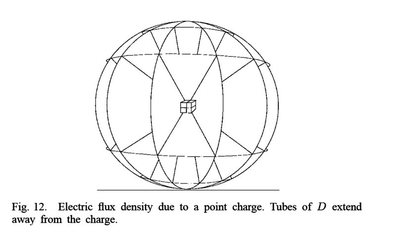

An electric field can be represented by a 2-form, and a 2-form can be represented by a geometric object, a tubular like structure.
See MTW, or http://125.71.228.222/wlxt/ncourse/dccydcb/web/condition/9.pdf.
So we expect the two-form to transform, the electric field, and the representation of the two-form as "world tubes" to all transform in the same manner.
So we expect the field lines (which are just the center of the tube structure of the two-forms) to transform like sticks.

Add importnat note: You need the B-field to be zoero for this arument to work.
The Warnick paper is nice -- thanks!
Well, what it requires is that there exist some frame in which B=0 (which I guess we can probably tell is true if, in some other frame, the invariant E.B is zero and the invariant B^2-E^2 is negative). In the old-fashioned tensor language, I find it easy to see why the transformation property we're talking about only works with respect to a preferred frame, and requires such a frame to exist. The transformation property treats the two frames asymmetrically, and this is also true in the case of the stick, which has a preferred rest frame.
Warnick's pictures of flux tubes, etc., are nice, but since the treatment isn't explicitly relativistic it becomes harder for me to see how you look at the pictures and see how they're affected by magnetic fields.
A.T.'s simple argument about a test dipole has some features that I'm now seeing are a little more complex than they appeared at first sight. In general, it is not true that an electric dipole p *in motion* points in the direction of the electric field. It experiences a torque [itex]p\times(v\times B)[/itex]. So let's say that there's a preferred frame K in which B=0. In this frame, clearly an electric dipole in equilibrium points in the direction of E. If we now transform into some other frame K', then in this frame we have both an E and a B, and both of them make a torque on the moving dipole. So in the new frame, the dipole's equilibrium is due to a combination of electric and magnetic torques...and this makes it seem as if the whole property shouldn't even be true...??
