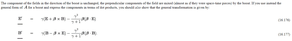

Okay, so the transformation given in this link: https://webhome.phy.duke.edu/~rgb/Class/phy319/phy319/node136.html
Does not answer the question: "If I am at rest in frame G, then boost to frame H, what will be the new electric field I measure?"

If this is the case, then why isn't the Lorentz transformation given in this link:
Related by a "simple" Lorentz transformation? That is, ##(E_G)_\mu \mapsto (E_G)'_\mu##
Is just
$$(E_G)_\mu = (E_G)'_\alpha \Lambda_{\mu}^{\ \ \alpha}$$
But this is not what the Lorentz transformation given in the link is. Or, in other words, what should we call
$$F_{\mu 0} \mapsto F'_{\mu 0}$$
This is what I was calling the "Lorentz transformation." But this is equivalent to
$$(E_G)_\mu \mapsto (E_H)'_\mu$$
Is just
The Lorentz transformation given in the link is the translation into 3-vector notation of
$$F'_{\rho \sigma} = \Lambda^\mu{}_{\rho} \Lambda^\nu{}_\sigma F_{\mu \nu}$$
In other words, it is a description of how you transform the EM field tensor. It is not a description of how you transform either ##E_G## or ##E_H##.

I am not saying that these should be equal. The use of the term "Lorentz transformation" perhaps should not have been used. But the formula in the link considers the following "transformation":
I should note that the author does not use the term "Lorentz transformation." Nonetheless, that is the transformation he is considering, and he does use the term "transformation."
The transformation
is what I (and perhaps others) have been calling the "Lorentz transformation of the Electric field." (Which, is probably not a good idea considering that term already has a meaning).
No, it does not. What you write here doesn't even make sense; ##F_{\mu 0}## is not even a valid geometric object to begin with, so talking about "transforming" it is nonsense.
The link you give talks about transforming the EM field tensor, just as I said. It then derives the 3-vector transformation equations, for the special case of a pure boost, from the 4-vector transformation equation.
You might be confused by the fact that, in the process of deriving the 3-vector equations, the article chooses the direction of the pure boost to be the "1" direction, and then explicitly shows what that implies for the transformed value of ##F^{01}##, which is the E field in the "1" direction. That does not mean the article is deriving a transformation equation for ##F_{\mu 0}##. It just means the article is leaving the details for the rest of the components of ##E## and ##B##, and how they all combine to reach the final result given, for the reader to fill in.

I believe that the following transformation (as in the article):
Is obtained by making the identifications
$$E' = F'_{i 0}, E = F_{j 0}, i, j \in \{1, 2, 3\}$$

\wE_{(\tilde y)}
&=& \gamma \left(\wE_{(\bar y)} +
( \vec \vW \times \vec \vB )_{(\bar y)}
\right)
\wE_{(\tilde z)}
&=& \gamma \left(\wE_{(\bar z)} +
( \vec \vW \times \vec \vB )_{(\bar z)}
\right)
\end{eqnarray*}
or, more compactly,
\begin{eqnarray*}
\vec \wE=\gamma(\vec {\vE} + (\vec\vW \times \vec\vB) ) -(\gamma-1)\vE_{(\hvx)}\hvx
\end{eqnarray*}
Note that in the derivation of ##\wE_{(\tilde x)}##,
the quantity ##\vE_{(\bar x)}## on the right-hand-side is really the component of ##\vE^a## along the ##\vW^a##-direction (using the unit -vector ##\hat \vW^a##).
Since we can write
$$\vE_{(\bar x)}
=\vE_{(|| \hvx )}
= \hvx \cdot \vec \vE $$
and
$$\vE_{(\bar x)}\hvx
=\vE_{(|| \hvx )} \hvx
= \left( \hvx \cdot \vec \vE\right) \hvx, $$
we can write this more generally for an arbitrarily-directed ##\vec\vW## as
$$\vE_{(|| \vW)} = - \hat \vW^a \vE_a = \hat\vW \cdot \vec \vE $$
so that
$$\vE_{(|| \vW)}\hat \vW = \left(\hat \vW \cdot \vec \vE\right) \hat\vW $$
Thus, we obtain the more general expression
\begin{eqnarray*}
\vec \wE=\gamma(\vec {\vE} + (\vec\vW \times \vec\vB) ) -(\gamma-1)\left(\hat \vW \cdot \vec \vE\right) \hat\vW
\end{eqnarray*} which agrees with the last set of equations for the Electric Field in OP's question ( Electric Field seen by an observer in motion ).
The magnetic field is handled in a similar way... likely easier using (or invoking) ##B_a={}^*F_{ab} \hv^b##.
