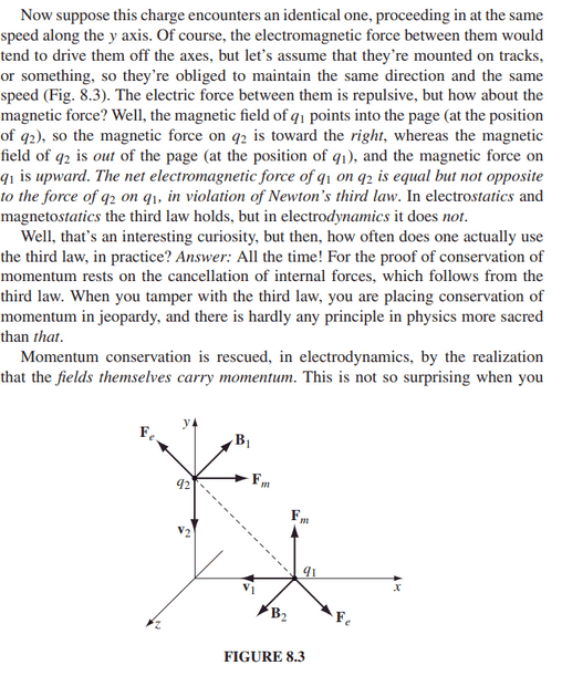

I am reading chapter 8th of Griffiths' electrodynamics (4th edition) on page 361 I stumbled upon this:
For figure 8.3 I don't understand why does the magnetic force of charge q1 points upward? According to right hand rule the thumb should point in the direction of v1 and then fingers curling around, show the direction of B1. This part I think is reflected on the figure because B1 points in the direction of negatve z axis. But then Fm should point in the direction of the palm which is into negative y axis while on the figure it is positive y axis, why?
PS: for Fm coming from q2 all is aligned with my right-hand rule description.
Thanks
Both magnetic forces look ok according to the right-hand rule. Are you comparing the correct fields for each case? Only the vectors drawn at ##q_1## (including ##\vec B_2##!) are relevant to the force on ##q_1##.

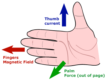

@Orodruin , I am talking about the Fm that is pointing upwards from charge g1 - how can it be upwards? The charge is moving to the left hence the palm rule says the magnetic force is pointing downwards.
No. Thumb in the ##\vec v_1## direction and fingers pointing out of the page in the ##\vec B_2## direction means palm is pushing up. Unless you are using your left hand …

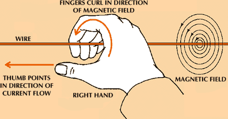

How is that possible? The charge moves to the left so below picture describes the situation:
So the thumb point in the direction of the charge q1, the magnetic field is into the page, but the magnetic force points down. The same rule applies to charge q2, and there it is ok, I only don't get the Fm coming out of charge q1.

That’s a completely different right-hand rule dealing with the direction of the magnetic field generated by a current. You can use it to figure out which way the magnetic fields should be pointing - not the force on the charges (they are also correct in the picture).
At this point there is unfortunately not anything more to say other than that you are misapplying the right-hand rule.
Take the picture from post #1, put your right thumb in the direction of ##\vec v_1## (ie, pointing left) and then - without changing the direction of the thumb - put your other fingers in the direction of the magnetic field ##\vec B_2##, ie, towards you. If this is uncomfortable anatomically (as is highly likely), borrow someone else’s right hand.
Barring any anatomical anomalies, your palm - and therefore the force - is now facing up.

No, again - you are trying to apply a right-hand rule that is not intended to be used to find the force. It is intended to help you find the direction of the field generated by a current.
The right-hand rule that deals with finding the force from the field and current has nothing to do with curling your fingers so forget that one if you are finding the direction of the force.
You need to take the field ##\vec B_2## at ##q_1## because that is the field that is not generated by ##q_2## and not by ##q_1## itself and therefore the field acting on ##q_1##.

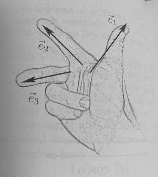

Yeah, I was taught it with a three-digit gesture like this one from the Wiki article on the right hand rule:
As a violin player and avid Mr Spock fan I had no trouble folding two fingers and pointing the rest in three different directions, but some people did. The gesture in post #3 is actually quite a lot easier to do.
Turning to page 4 of my book, we see that I can also do it 😉
(it is actually a photo of my hand somewhat processed by GIMP with added vectors on top)

To the OP, the force exerted on a point charge is not influenced by the field produced by the charge itself. This applies to both electric and magnetic fields.
Yes the 'not' seems to be wrong there, but this post helped me to catch my main problem - I initially thought that Fm at point q1 is there due to the magnetic force generated by q1 itself. While this is a force in response to the magnetic field of charge q2 alone.

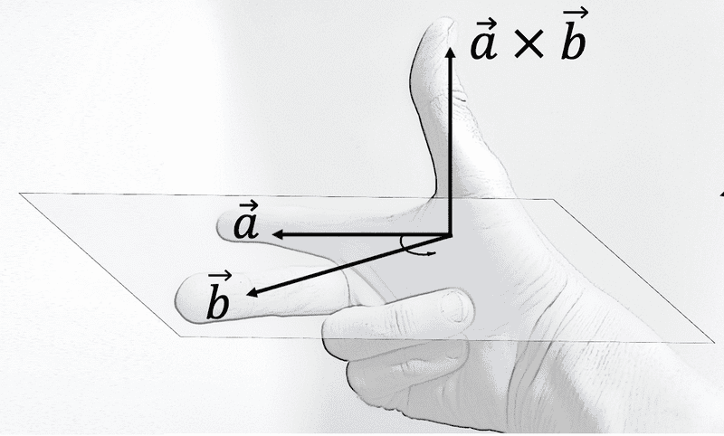

Sure, but it distinctly inticates just 2 directions . How do you memorize that the force comes out of the palm and not the back of the hand? You can't tell students "It's the way you bi*ch slap somebody".
PS: You can't even write it on this forum. It gets changed to "jerk", which confusingly is a different physical quantity.

Using the gesture below, it's quitle logical: The order of the fingers is the same as in writing down the cross product:
e1 x e2 = e3
In fact, I always start with a closed fist, and extend them one by one in that order.
