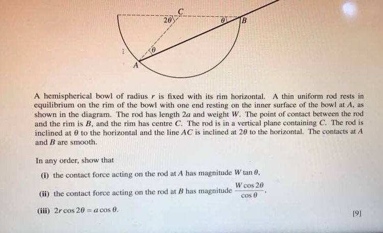

Can somebody please assist me in finding the direction of the normal force exerted on B? (How is normal force at B also normal to the rod? )
There is no hint provided from which I can conclude the direction of normal force. Can somebody please provide a hint so I can work it out?

If only one has a tangent plane (as in the picture), use that.

Considering the diagram given on the section 1 of the reference page, if we were to move the rod at a very very small angle keeping the contact point constant, the direction of the normal force will remain same but it won't necessarily be perpendicular to the rod.

I do not understand your response. That section tells you how to figure out the direction of the normal force in a point contact like the one in this question. Isn't that what you wanted to know?

if we were to move the rod at a very very small angle, the direction of the normal force will remain same
No, it would move exactly as the rod moves and remain perpendicular. Why not?
Oh. So no matter how the surface of contact is, if my rod is a straight rod the contact force will always be perpendicular to the surface of rod?
But this point will not apply for the edges of the rod right? Because the straightness ends over there?
Yes. It follows from the definition of normal force that I give at the start of the section.
It will not apply at the tips, no, because there is no well-defined contact plane there. Generally you will be able to figure out the contact plane from what the tip touches, as in the question above where it rests in the bowl.
