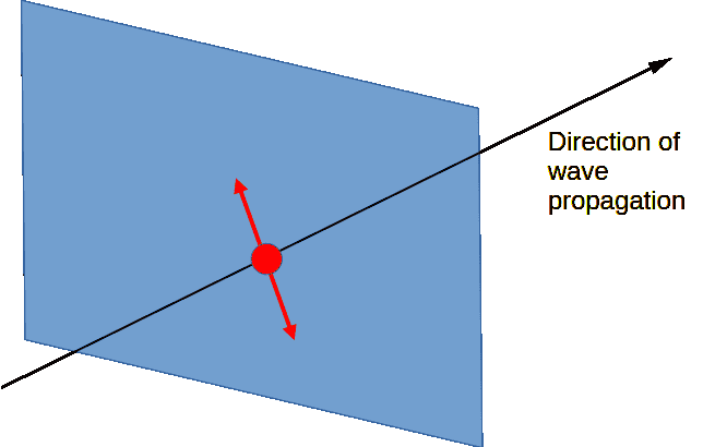

EM waves are difficult to visualise but this may help (at the risk of being accused of oversimplification).
Imagine a plane polarised EM wave passing by a small test-charge (red dot in diagram). The wave’s oscillating E-field produces an oscillating force on the test-charge. The test-charge oscillates along a line; the line matches the directions of the wave’s E-field.
For example, if the charge oscillates along the red line in diagram, then the E-field directions match the red line. There in no test-charge motion (therefore no component of the E-field) in the direction of propagation (z) because we’re dealing with a transverse wave.
Edit. The line lies in a plane (blue) perpendicular to the direction of propagation - and this is the plane referred to in answer option D.
