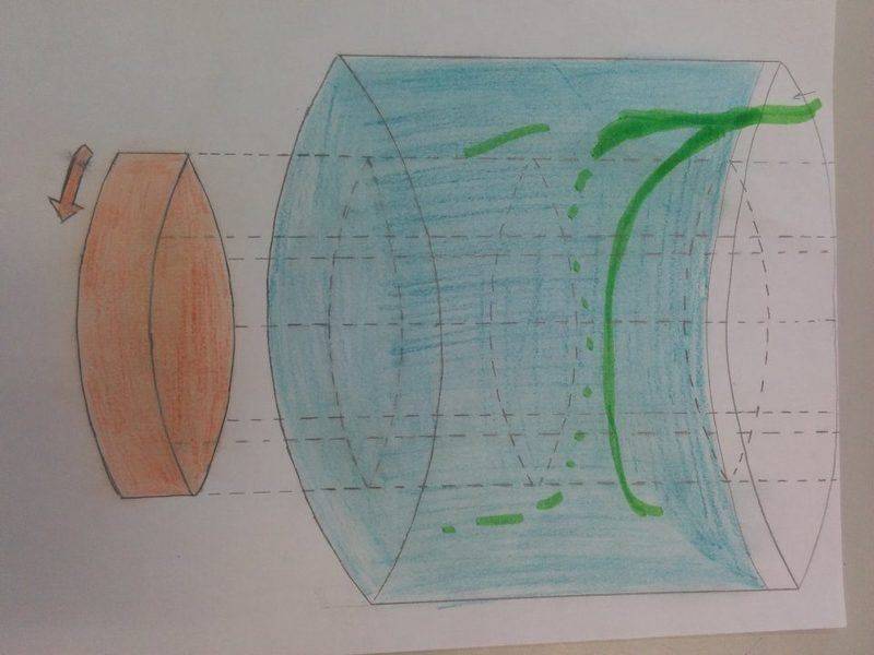

Long time ago i saw a video of a physical phenom. The procedure was : At the bottom we have something like a puck (a circle with thickness), which is rotating. And above with have a jar of water. And when we throw some dye. We can see that phenom : there is like an invisible cylindre that follow the circle at the bottom but in water. So we have the dye who spread everywear but not in this cylindre.
I can't remember what was the name of the phenom, and i coudln't fint it with key-words on internet. Thanks for helping me.

Are you thinking of this?
I'm not sure if there's a specific name for this, though it works because the ink doesn't spread much, and the flow of the fluid surrounding the ink is not turbulent.
Instead of dissolved, I think one says that the ink is enfolded in the fluid.
To me it sounds like you may be describing a Taylor column. Try looking in the videos section of
spinlab.ess.ucla.edu
Jason
Thanks for your response.
Sorry jfizzix this not this.
Jason, this was just like Taylor column but the object was not un the water. Your answer help me a lot
