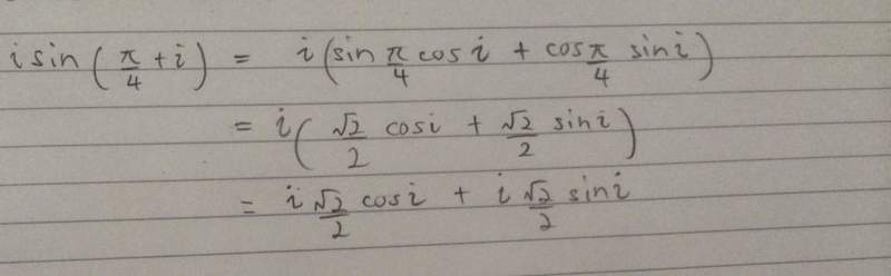

Does that mean I didn't have to use the trig identity?
You just need ##\sin i## and ##\cos i## to finish, don't you? You can get them from the above formulas.

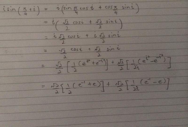

Err...you mean like this? But it gets complicated.

Wait, I think I got it. Hold on, let me try and solve it and I will show it you.

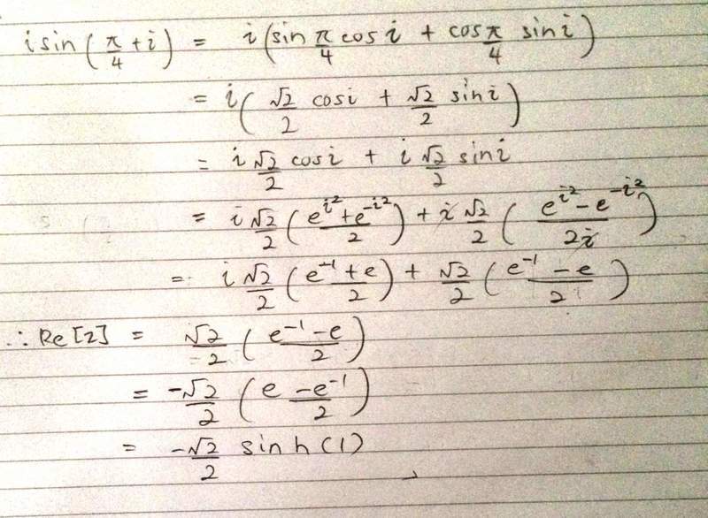

Is this correct?

That looks correct. Notice that you could have substituted the exponentials for ##\sin(\frac \pi 4 + i)## directly, avoiding using the addition formulas.

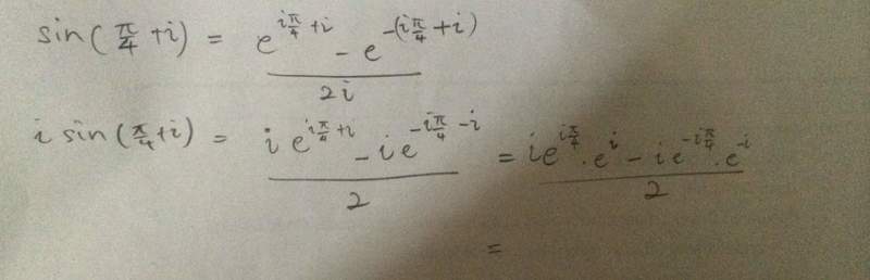

You mean like this? But then how do I finish it? Looks complicated there.

What happened to ##\ i\ ## in the denominator?
Do you know what ##\ e^{i\pi/4}\ ## is ?

I forgot to write the i.
##\ e^{i\pi/4}\ is equals to cos∏/4 + isin∏/4, right? And that makes it equals to 1/√2 + i/√2, right?

Yes, and ##\ e^{-i\pi/4}= \ ? ##
