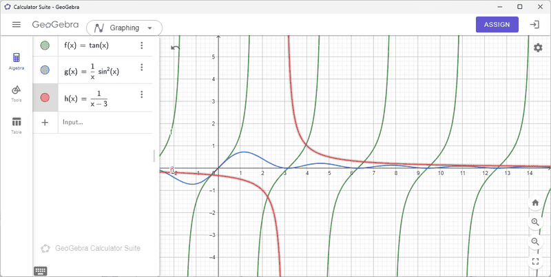

The problem asks you to discuss those functions, not necessarily to mathematically prove what you discuss. Can you recognize an uniformly continuous function when you see its graph? Here are the three functions.
Discuss. :-)
GeoGebra graph of three functions on one axis set: f(x) = tan(x) in green with repeated vertical asymptotes, g(x) = sin²(x)/x in blue, and h(x) = 1/(x − 3) in red with a vertical asymptote at x = 3.
