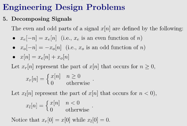

To be honest, I don't think you can prove something is impossible with just a sentence or two.
I don't see why we check x odd [n] and x left[n] at 0 and notice they are both 0.
1. Why do we think to examine those numbers?
2. What do them both being zero tell us?

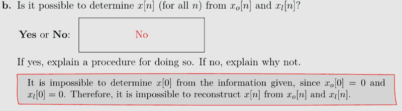

In a mathematical sense, the question is asking if this equality holds:
$$x[n] = x_o[n] + x_l[n], \quad \forall n \in \mathbb{Z}$$
In words: Can we re-construct ##x[n]## from the odd part of the signal plus the part of the signal to the left of ##n = 0##, ##\forall n \in \mathbb{Z}##?
Intuitively this cannot be possible, because the even part of the signal for ##n \geq 0## will be excluded from the re-construction of ##x[n]##.
If you can imagine it, there would be a continuous line to the left of ##n = 0## because of ##x_l[n]##, but for ##n \geq 0##, there would be many holes in the signal because only ##x_o[n]## is accounted for.
If the equality given was instead ##x[n] = x_r[n] + x_l[n]##, it would be possible to re-construct the signal.
