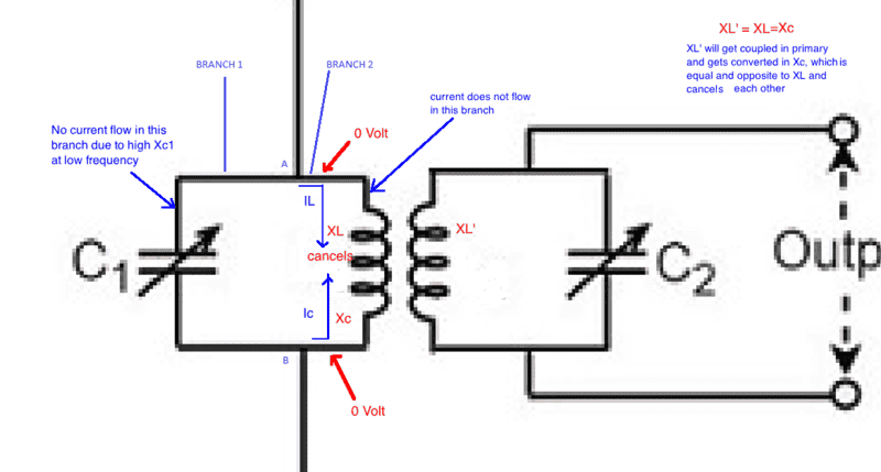

Hi friends,
My question...
At non resonance frequencies the resistance of primary is minimum or maximum?
My analysis...
There are two tuned circuit tuned to same frequency . In primary circuit at low frequency XL is low and large amount of current will flow at the inductor L1, now due to this same current is generated in the secondary circuit because both the circuit are tuned to same resonant frequency. The impedance coupled from the secondary will be of same magnitude but opposite in sign and will cancel the inductive reactance of the primary circuit as discussed per theory. Now since XL is canceled in the primary so no inductive reactance will present which technically means that there will be no driving force which will cause large current to flow in the primary circuit as earlier. This can be thought as an "occurrence of large impedance which cause little current flowing in the inductive branch of primary circuit." So at non resonant frequency the presence of a tuned circuit in the vicinity of other tuned circuit fixed at same resonant frequency will cause high primary impedance to persist which force me to assume that at non resonant frequencies the primary resistance is high..
but according to theory its wrong. The text states that at non resonant frequency the primary resistance is low which causes large current to flow causing occurrence of two humps in the output curve.

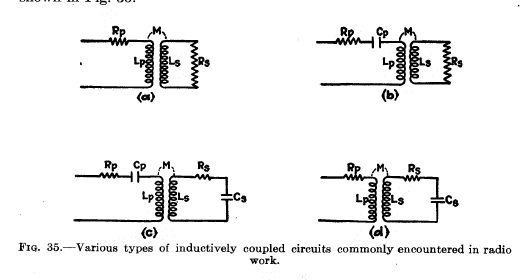

I do not think there can be a useful discussion without the circuit diagrams.
We need Fig 35(..cd..) from one book, and Fig 23.32(abc..) from the other.
What are the titles, authors and editions of the books you extracted the partial texts from ?

Let me elaborate more …
As both the tuned circuit is tuned to same resonant frequency.
At low frequency the secondary inductive reactance XL’ is coupled into the primary as capacitive reactance Xc. This Xc cancels the inductive reactance of the primary XL which is already present there.
This cancelation of impedances brings point A and B to the same potential which prevents the current flowing in the branch 1. No current will flow through C1 as at low frequencies Xc1 is very high. So technically speaking no current is flowing in the primary which means that at non resonant frequencies the primary resistance is high…

Fig 35 c,d

It seems that you might mean the input impedance is high. The annotated circuit diagram you give at the top of post #5 has no resistance components and no output impedance specification. That means it has an infinite Q, with a huge circulating energy at resonance that cannot be lost. You continue to confuse resistance R, with impedance Z = R + jX.
The circuit will have low impedance at low frequency since parallel Lp is XL = 2 π f L.
The circuit will have high impedance at high frequency since Lp Cp is resonant and lossless.
The circuit will have low impedance at high frequency since parallel Cp is XC = 1 / ( 2 π f C ).
You claim that the two resonant circuits are tuned to the same frequency, which is not the case with the variable M coupled stagger tuned circuits being discussed in the different texts.
