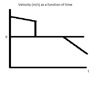

The graph below shows the vertical displacement of an object as a function of time.
(a) Construct a graph of the object’s velocity as a function of time.
(b) Construct a graph of the object’s acceleration as a function of time.
(c) Describe a scenario in which a real-life object might move in this way
Ok, Here is a picture. Graph A represents the original graph that we construct B and C from. I am not sure if I drew graph B (velocity as a function of time) and C (acceleration as a function of time) correctly. Did I?
Also for a potential scenario, I can't come up with anything except for maybe a helicopter that goes up to a certain height, then hovers at that height then comes back down. But I'm not sure about the curvatures on that original graph A so I want to make the scenario detailed.
Thanks!

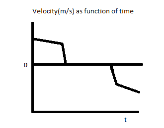

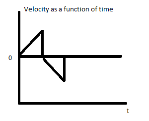

Ok, after taking your advice this is now the graph I get of velocity as a function of time constructed from the graph A in my first post.
Is it right?

That is looking better. Though we don't know that those sloping straight lines should actually be straight lines, it is better than your first post's graph (B).
The right hand side of your plot should not end like you show it, though.

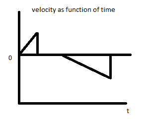

Is this better for velocity as function of time?
Also, would the acceleration just be a straight line at zero?
No, that is not better. A period of constant velocity would show on the displacement-time plot as a straight (though sloping) line. There are no such lines on the distance-time plot given for this question. What you had was good enough for now.

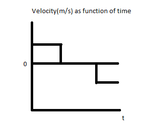

Ok I drew this velocity as a function of time graph. This is accurate, correct?
Pay attention to two regions:
That second region you circled shouldn't be there. It was a mistake on my part when i drew the graph in paint. Pretend that the graph ends when it hits the x axis.
Okay. But how did you decide (on the right hand side of the plot) there is a sudden bend in the line halfway while the object returns to zero level?
The arrow points to a point in time where distance was rapidly changing with time then it abruptly stopped changing. That happens when speed has an abrupt drop to zero.

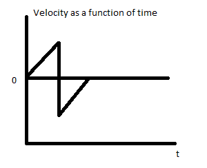

Ok, I see the abrupt change. I went back to the graph I drew before and modified the second part.
Is this more like it?
You have the first abrupt change to zero velocity correct, but you are still not showing the second one. When the distance graph finally returns to the t axis, it stays there, so velocity is now zero.
Also, because distance ends up where it started, at zero, the total area under the velocity graph (counting areas below the t axis as negative) should be zero. I.e. the total area above the t axis should be equal to the total area below it.

The left hand half of the plot is looking good. Next, that 120 degree bend you show in the right hand half, why did you draw it like that?
Well because there is no abrupt change in the second half of the graph, it flows.
So why did you show an abrupt change in the way velocity changes where there is no abrupt change in the way displacement is changing?
Anyway, you should get back to the graph you drew here. https://www.physicsforums.com/showpost.php?p=4503814&postcount=5
Now that you cleared up the artifact I had circled, that graph from earlier is correct!
Now you can determine the acceleration vs time graph. (The one in your very first post is not correct.)

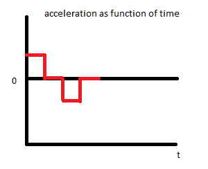

Ok. Now to derive acceleration from this velocity time graph I will find the slope ((vf-vi)/(change in time)) of each segment of the graph.
Here is what I get for the acceleration as a function of time graph.
You used a ruler like I suggested? Aligning it to be tangential to the graph as you slowly slide it from left to right. You won't quite get that graph.

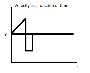

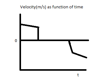

Here is V3.0 of velocity as a function of time:
Still trying to work this out. First the object increases from 0 velocity to max velocity, then it instantly drops to zero velocity, then 0 velocity decreases to max negative velocity then it instantly hits zero.
I have now concurred that it is 100% impossible to convert this graph from displacement - time to velocity - time. This is probably my final answer.
Ok, this is my final attempt. If this is wrong, I give up.
and here is the the graph of acceleration as a function of time I am sure of it.

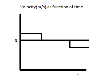

Ok after even further time analysis, I believe this to be the velocity as a function of time graph:
