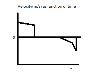

Displacement as Function of Time Graph Question
73 replies · 13K views
One of your previous responses was closest to the correct answer (#12).

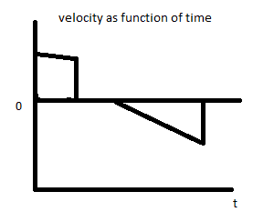

Ok. But at the end it accelerates slow then quickly accelerates. So should it be this?
Here is what I'm getting for acceleration now:
No. It should essentially be exactly the same as #12, but with a vertical line coming up from the final point at the right-side, up to the t axis.
Could you please explain why it makes that bend in the right hand side of the graph?

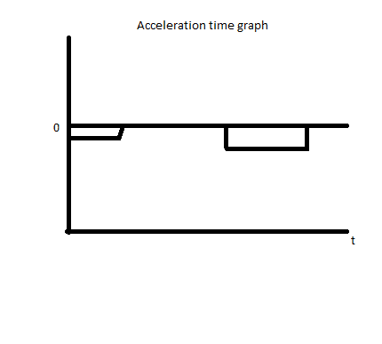

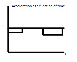

Ok. So here is the acceleration chart I'm getting off of the velocity chart. Looks good?
I'd give you 4 out of 5 for that. :smile:
During the object's travel, there is a moment which could be described as <CRUNCH!>. Where is this point, and how would it show up on the acceleration vs time plot?
I'd leave out that right hand side vertical line. It's doubtful.

Hmm, I'd say it would show up at both the zero acceleration inbetween and at the end.
Your answer is not clear.
If you were that object, at what point(s) in time would you be most likely to suffer bruising? Can you put yourself into that scenario?

Hey guys. Please excuse me. Sorry I didn't notice that the zero slope on the right side of the plateau in the distance time graph was continuous. So this present figure is a better representation of the velocity variation than the one I recommended using in post #12.
Chet

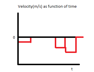

ok i will try this.
So you're saying the acceleration time graph should look like this?

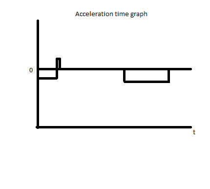

Except you told me that we don't know what happens there, where I circled at the right. The recording stops as soon as the object passes through zero displacement. We don't know whether it smoothly continues on to a negative displacement or whether it halts at zero (you drew it showing that it stops at zero, but then clarified that you did that in error). So the end of the graph is an unknown; we definitely cannot say there is a bruising crunch there.
What is happening where I drew the red arrow?
EDIT: Ah, I see you answered already:
Is it when the object moves up, then proceeds to stop moving up instantly?
Yes, there is a sudden change of speed there. So how to improve your acceleration vs time graph to show this happening?

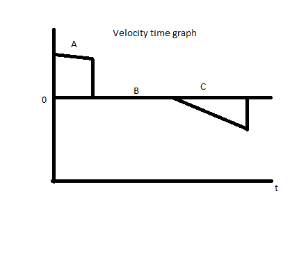

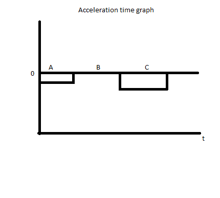

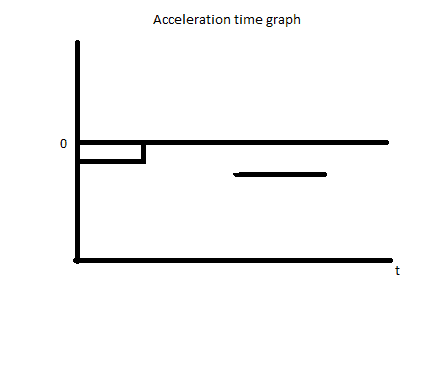

I'm just not seeing it. When I separate this graph into three distinct segments ( reflective of the three in the displacement time graph) this graph seems to make perfect sense to me:
Also, would a good scenario be similar to the one you said previously, but instead of a t-shirt, a wet toilet paper ball is thrown to the ceiling, sticks to the ceiling for a few seconds, then falls back down?
Okay. Stop right there. Here's an exam question: an object with some initial upward velocity is subjected to the acceleration you show in your graph. Sketch the expected velocity vs time graph.

The acceleration time graph I made just seems to work for this, I honestly can't figure out the change:
During period A, under the influence of a constant acceleration, the velocity is seen to be steadily decreasing. When acceleration disappears by fading to zero, the velocity will remain as it was at that moment. There is nothing to cause it to suddenly drop to zero speed.
So, can you now sketch expected velocity vs time for the acceleration vs time graph you drew?

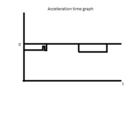

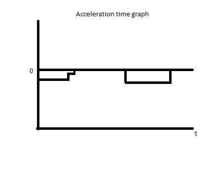

If the velocity changes from a nonzero value to zero in an extremely short time, how great is the acceleration?

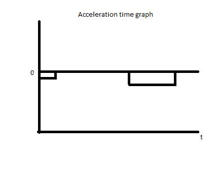

not very great. Perhaps if I draw it less on my graph?
You're saying it should look like this:
