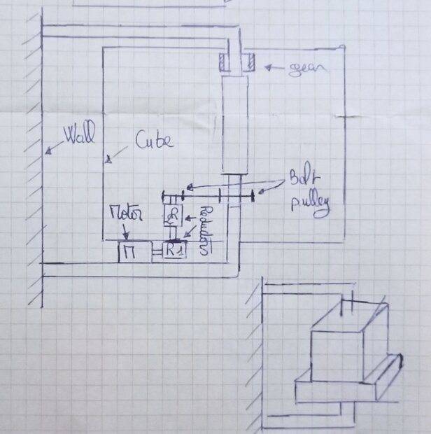

I want to build a rotating display cube (will be mounted on a wall, those cubes that has shops logos ect..), my problem is that I don't know where to start and how to attack the rotating mechanism.
Hello everyone, I want to build a rotating display cube (will be mounted on a wall, those cubes that has shops logos ect..), my problem is that I don't know where to start and how to attack the rotating mechanism. I have a 1400Rpm moteur (and it's a 1m per 1m cube that weights around 120kg-150kg once finished ) mand my desired rotation for the cube is 6Rpm so definitely going to be needing 2 reductors(reducers), and belt pulley system for the mounted turn table/axe. Now I'm confused because I don't know where to start my calculations and which equipment should I use or the adequate system for such a project. I will appreciate any help and suggestions considering this topics (Links, formulas, blueprints, guidance anything...). Thank you in advance.
A good place to start is to make and post a sketch showing what you want the finished project to look like. The sketch should show the axis of rotation.
Will it be outside ?
What is the maximum possible wind speed ?
How much snow and ice could build up on the cube ?
You're absolutely right, and sorry about that!
It should be something like this or at least this is what I came up with as a start.
Thank you for your response.
Maximum wind speed is around 35km/hours, it will be mounted outside approximately 5m above the ground, surrounded by higher appartements ect..Snow is out of the equation luckily.
(Again sorry if I'm not using the right terms for this)
Will it be possible for people to walk underneath?
Yes, there is a sidewalk under it and it will be mounted on the side of a shop access 5meters above. (I'm having a problem with the rotation mechanism and how/which components to use and calculate in order to get the desired speed (basically slow rotation, ideal 6rpm). )
Do you also have a significant liability, and a problem with insurance.
No no problems, but of course will make it as secure as possible. Will take everything in consideration.

You may need a building permit for that, and to submit plans to the city.
Here on Physics Forums, we usually do not give advice on building structures, especially those that must meet local building codes. We don't have access to your local building codes.

In addition to the permit and inspections, overhead outdoor moving structures require engineering input from a person with knowledge of your specific environment. That person must also be familiar reliability centered design. This project requires input from a professional engineer on-site. Please look into hiring a local professional engineer to help you with this, and please also be sure to get input and buy-off from your professional building insurance that you currently cover for your business.
