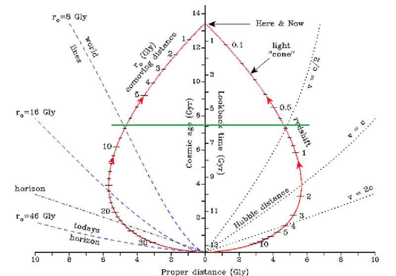

I used a picture, not a calculator. There are several, but one is marked with redshifts, and I used that. It being decades old, perhaps the models/constants have been since updated, so I'm not saying your values are wrong.
z=0.66 (labeled along the red light cone line) falls just left of that v=c/2 dotted line.
Notice that for high redshifts like 13 (some of the most distant things that Webb has spotted), light was emitted from only 2.5 GLy away, much closer than the light from this z=0.66 object.
It's harder to find a similar picture extrapolating into the next 25 Gyr or so, but they're out there.
Yes, that's the distance it was at when the signal was emitted, but I'm referring to the distance the galaxy is currently at, which is established by the green line in your graph and corresponds to about 7.8 Gly.

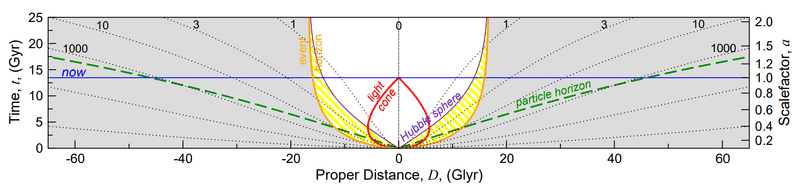

A better one for this purpose would be a conformal diagram, in which light signals move on 45 degree lines.
There is no green line in my pic, and nothing drawn at 7.8 Gly, although the c=1 worldline is crosses that proper distance about 7.5 Gyr ago.
That works, but doesn't give an easy answer (proper distance, cosmic time) to this distant galaxy event when it receives our signal emitted today, redshifted by z=0.66. Given a transformation from conformal time to proper time, the numbers can be had, yes.

Jaime Rudas said:
I drew the green line in your drawing, as seen in post #6.
Was no drawing in post 6. I refreshed the topic, and it appeared. Tech problem.
OK, you drew a line of constant time at just under 6 Gyr ago (close enough to the 6.3 quoted). It hits the z=0.66 mark on the red light cone, about 4.6 GLy away. The line doesn't go out to 7.8 GLy, where there isn't anything special.
Perhaps you mean that 6 GYr ago, the universe was of age 7.8 GYr, to which I'll agree. But that's not a distance.
Ibix said:
Do you have a source for your graph?
Possibly here, but maybe even this reference was copied from some prior work, but it says "figures made for this website", an educational page
http://lifeng.lamost.org/courses/astr553/Topic16/t16_light_cones.html
The 4.6 Gly are the distance at which the galaxy was when it emitted the light that reaches us today with z=0.666. According to your picture, that galaxy is now 7.8 Gly away, as can be seen in the left branch of the red line, which corresponds to the comoving distance, that is, the distance at which the galaxy is TODAY.
