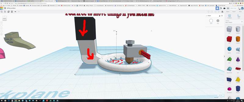

Actually I might be able to spare you that fate...it's still my file but this is a (reasonably) accurate mockup of the working area of our 3D printers...in this specific case, the ANet A8.
Pointy bit with the red wires going into it is the heated block - gets up to around 200 degrees centigrade, melts the plastic which is fed in through a tiny hole in the top (0.4mm diamter)
The black box is the air inlet, fed by a (I think) 24v blower fan - takes in air axially and expels it downwards where it enters the duct, which is the "design target" of this post. The duct is designed to cool the workpiece (plastic) more rapidly, thus setting it before it flows out losing detail. Prints that are cooled well are sharply defined, prints that are not tend to be a bit "wobbly" looking.
The duct pictured is a circular one...it was my opinion that it would put more air out through the holes immediately in front of the inlet, and that less would come out "round the back"...and yes, ideally the nozzle should be in the centre...people tend to modify their printers so not all fan designs "fit" perfectly without a bit of tweaking...
The original duct as supplied with the printer is a simple ducks bill type affair...though there have been several variations since...I may add a few to the 3d workspace if I can find time...(edit:: there are now a couple on the left)...
The whole assembly pictured raises up and down a layer at a time. Depending on the complexity of what is being printed, the fan could either by effectively sitting on a "plane" of plastic, or in mid air with only a very small surface in front of it under the nozzle.
Because of this I'm starting to think there is no "perfect" fan duct solution...that would require selecting a different duct depending on the ratio of "plastic to air" under the nozzle at any given time, which is impractical. But is there a design that can be the best "average" performer, regardless of whether it is sitting on mostly plastic or mostly air?
Remember the "trick" is to cool the work, not the nozzle...so I feel improved directional control may be the way to go, but I'm not skilled in this, I just have a tendency to look at things and think..."what if"?...
Such as...
What if the holes in the ring design were replace with a single circular vent, angled down at "x" degrees?
What is the performance difference between a 2mmx18mm vent and a 6x6mm vent (if any)?
Would "rifling" the vent narrow the focus of the air - and is that beneficial?

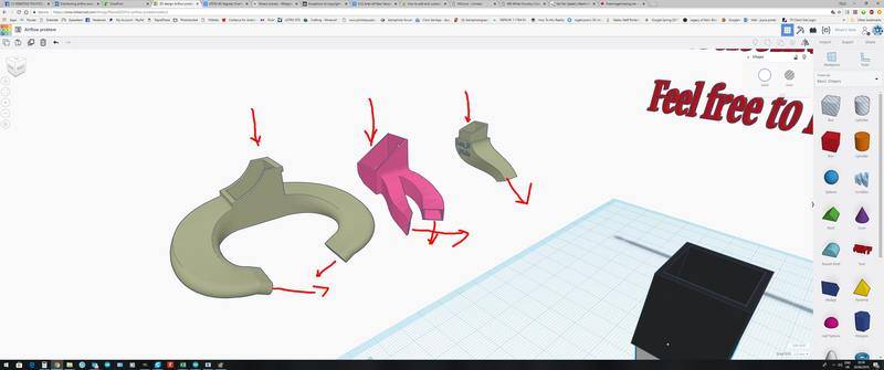

There are designs where the air is split between two "letterbox" vents at 180 degrees to each other (though facing slight downwards). What effect is the mixing of the two streams having on cooling? DOes it slow the air down and thus reduce efficiency?Would it be better if they were angle to "just miss" each other?

OK took some screenshots of the tinkercad page...hope they help..
The setup;
The other design options;
