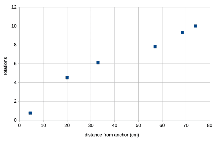

Well, I just tried it and I didn't see anything surprising. What did I miss?
I rotated the weight ten times and counted the rotations at the five pieces of tape I stuck on gthe string. I guessed at the fractional part of the rotations so it's not highly precise. And the tape distances I rounded off. But it looks like it is probably linear. Isn't that what you'd expect? Or is the non-linearity that showed up in my sloppy measurements the same as what you saw?
The first sign of torque failure of a round wire, is when the twist is not spread evenly along the wire.
If you want to reliably rotate a suspended load, hang it from a tape or a ribbon, not from a round wire.
The outer half of the round wire, forms a torque tube, about the neutral axis core. A round wire will be more rigid than a ribbon of the same sectional area. A round wire will work harden, the torque tube will fracture from the surface, where micro-cracks form, propagating fatigue internal corrosion.
