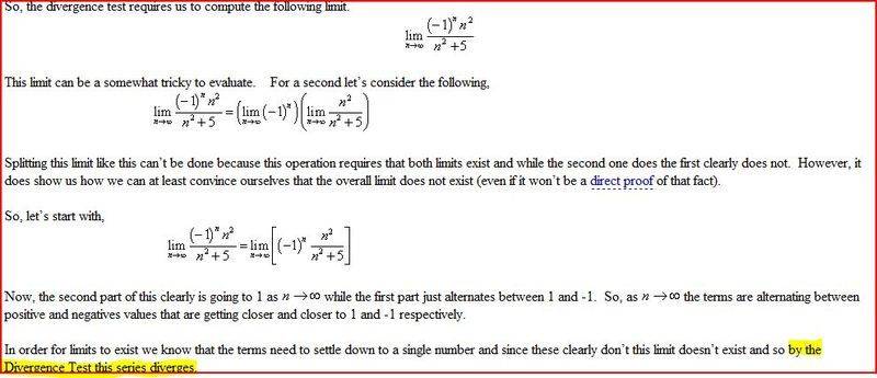

So I started off by looking at a divergent alternating series on my way I ran into a little problem that confused me. I attached a photo of a solution to a divergent alternating series that I found confusing. (

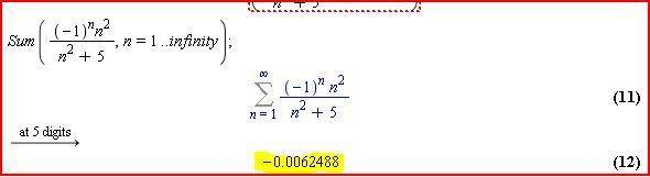

). As you can see the test diverges. And this is my problem. When I plugged this into my maple and approximated it went to -.006... I don't understand why this would happen if the series is divergent. I included a picture of my approximation on maple. (
) I might be wrong, but wouldn't you expect to get nothing if the series was divergent?

I can't explain Maple's answer. I guess that it is because maple cannot evaluate an infinite number of terms. It evaluates a finite number and then displays the result.
You are indeed correct that the series you suggest doesn't converge. Mainly because the limit
[tex]\lim_{n\rightarrow +\infty}{ \frac{(-1)^n n^2}{n^2+5}}[/tex]
doesn't exist.
However, the absolute value of the series also doesn't converge.

The thing about maple though is that when I evaluate any other divergent series with n=1.. infinity... Say I input Ʃan and then I got to approximate then the output is the same as my input Ʃan. So I have always assumed that when that happens it shows the series is just divergent so seeing this really threw me off and I don't have an explanation for it. Its obviously a fault with the program, I just can't see what it is.

I'm guessing that what Maple is doing is regrouping your series into (n+1)^2/((n+1)^2+5)-n^2/(n^2+5) and then summing that over n=1,3,5,7,... That series does converge. Regrouping a divergent series to a convergent one is possible but it's illegal and misleading. Another reason to distrust Maple on questions like this.
Oh that makes sense. Thanks for the help.
