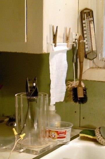

The last cool thing I made was a Relative Humidity/Dew Point sensing device.
It consisted, of a wet paper towel, a muffin fan, and an infrared thermometer(not pictured).
It worked!
Unlike my vintage, indoor/outdoor thermometer, which claimed that it was 112°F outside. I think it was closer to 50°F this last Monday. It's marked off in 2°F increments. So, I think scientists would say it has an accuracy of 2°F +/- 62°F. Or they might say, that I should throw it away.

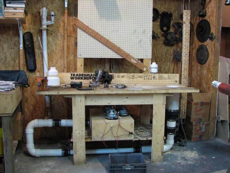

An older pic, but back in '07 or so I built a flowbench for testing cylinder heads and manifolds. I had it set up to measure up to 36" of depression, but it could probably have pulled close to 96" if I had two more motors and a taller U-tube manometer. Sounded like a jet engine with all of the motors running under load pulling through a 1" orifice. Definitely one of the more interactive things I've built.

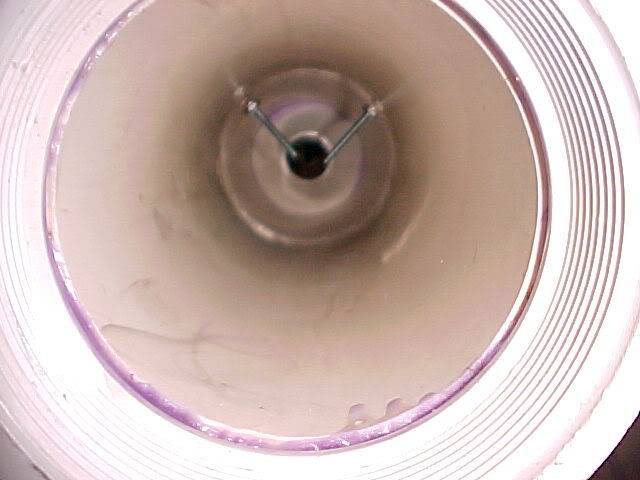

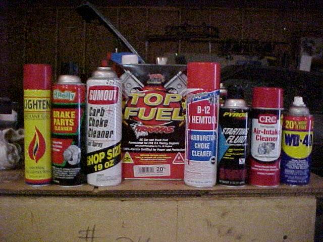

And after building a flowbench out of PVC pipe, what do you do with the spare parts? Build a potato cannon of course! :D Also had to perform a series of tests using common flammable workshop liquids. A 20,000 volt stun gun works much better than a grill lighter.

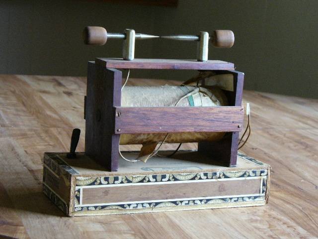

A few years back I built an old fashioned spark coil:
