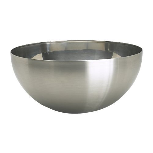

This discussion focuses on constructing a Van De Graaff generator using two hemispherical bowls that have warped during shipping. The primary concern is whether to connect the bowls with aluminum tape or an alternative method to prevent coronal leakage. Participants recommend aligning the bowls as closely as possible and suggest using aluminum foil to create a smooth seam, avoiding protrusions that could lead to discharge. Additionally, safety precautions are emphasized due to the high voltage involved in the project.
