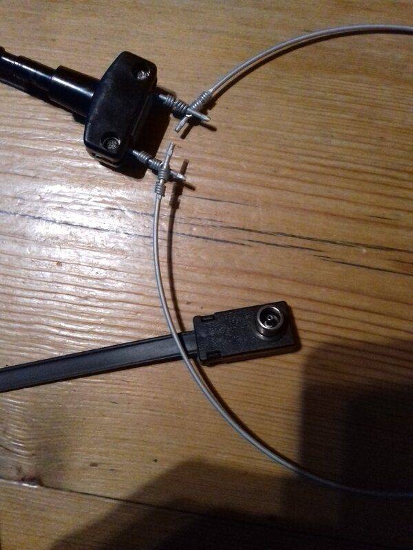

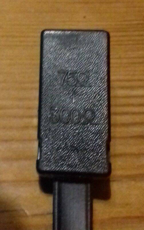

I definitely agree with your first para, but I always thought a balun was used to match an unbalanced cable like coax to a symmetric antenna like a dipole, even if there was no impedance mismatch. (Or to join balanced feeder like twin line to unbalanced cable or socket.) Balun and matching transformer functions are often combined, and called, say, a 4:1 balun used to join 300 Ω twin feeder to 75 Ω TV coax input socket.

Strictly speaking, a balun is used to convert between balanced and unbalanced lines.
But as you say, a balun will usually have an impedance ratio, typically 4:1 for commercial TV.
That impedance ratio is often more important than the balance.
