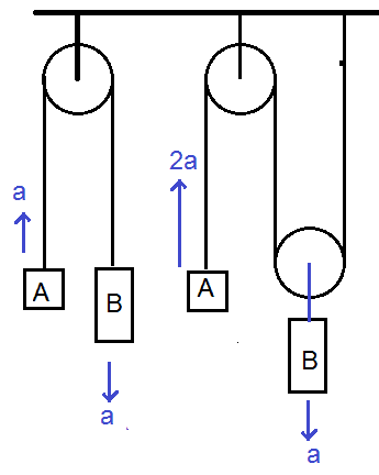

The way my teacher makes us solve for accelleration in pulley problems is by calculating the net force of the system as a whole and then using F=ma, with the total mass and total net force. Are you supposed to solve for something like accelleration separately for each mass or do all masses in a pulley have the same accelleration?
F=ma
Does it make sense to solve for the accelleration of the system as a whole or of the separate masses? I'm not sure.

All the mass have the same acceleration, if not that would mean that the cable connecting 'em would change it's lenght

If all masses have the same acceleration, depends on the problem.
In the figure on the left, the masses have the same acceleration, A upward and B downward. On the right, the accelerations are not the same. The upward acceleration of A is twice the downward acceleration of B. Make a free body diagram for each mass and find the relation of their accelerations from the condition that the length of the string must be constant.
