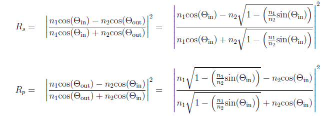

I have a monochromatic light source (wavelength ~ 420 nm), which will be incident on the interface of two different media. Could someone please explain if the Fresnel equations applies with monochromatic light when estimating the reflectance and transmitance?
Thank you in advance!
Fresnel equation:
Would it help if I pointed out that the index of refraction n = n(λ)?
Thank you for your hint, now I realized that I also need to take the wavelength into account.
