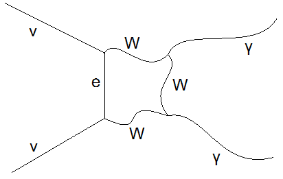

This could work, not sure, but the alternatives don't look better. Now we just need Exawatt neutrino beams hitting each other?
Feynman diagram: two incoming neutrino lines labelled v meet at a vertex with an internal line e, which connects to a loop of two W boson lines, ending in two outgoing lines labelled γ.
Is that before getting 2 Z0 and a box of fermion-propagator that results in the 2 gammas?
I think the Z--->gamma gamma by a triangle fermion loop doesn't work...
http://arxiv.org/pdf/1402.1203v1.pdf
That's why, although I thought about it at first, I didn't mention it. Or I am misunderstanding the first phrase after all in the 5.conclusions section.
Assuming this is also true for our off-shell Z: okay.
Anyway, all those diagrams have extremely small (or zero) probabilities. Way too small to look for them.
