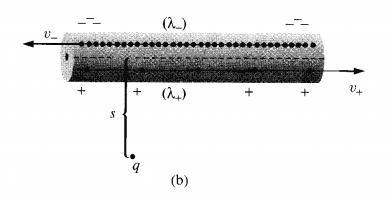

I want to understand how electric and magnetic fields change as measured from an inertial frame ##S## vs. as measured from an inertial frame ##\bar {S}## (which has uniform speed v wrt ##S##). I am working out the following example to do so:
We have a cylindrical symmetric wire of radius R, with constant charge density ##\rho## and current density ##j##. (i.e the current I is uniformly distributed over the wire of circular cross section; assume the flow goes from left to right).
We know that its magnetic field ##\vec B## is ##\vec B = \frac{\mu I}{2\pi s} \hat {z}## (where ##s## is the radius of the Amperian loop) outside the wire while ##\vec B = 0## inside the wire. Let's draw out attention to the external magnetic field.
We know that its electric field ##\vec E## is ##\vec E = E \hat {r}## (where ##\hat {r}## accounts for radial direction).
Now let the wire be in an inertial frame ##\bar {S}##, which has uniform speed v (from left to right) wrt your frame ##S##.
a) Could the electric field become ##\vec E = 0## as measured in frame ##\bar {S}##? Why?
b) Could the magnetic field become ##\vec B = 0## as measured in frame ##\bar {S}##? Why?
I think that time dilation plays no role on changing neither ##\vec E## or ##\vec B## because these are uniform (time-independent) fields. Thus, let's focus on Lorentz contraction (moving objects get shortened).
a) ##E## won't change because Lorentz contraction does not apply. ##E## is perpendicular to the velocity of the frame; dimensions perpendicular to the velocity are not contracted.
b) The magnetic field should be contacted, so it changes. But does that mean that we could make it become zero?
Thanks

I have been reading Introduction to Electrodynamics by Griffiths chapter 12, section relativistic electrodynamics. He deals with line charges (##\lambda##) and plates.

I have just seen that I was wrong stating that ##E## doesn't change in a moving frame. This is how the wire looks like in the moving frame:

Let me recap after some reading.
I am interested in knowing whether ##E## or ##B## can become zero in a moving reference frame. (we know that that could be the case, but let me discuss it to see if I understand why).
The original problem was about a cylindrical wire with radius ##R##, ##\rho## and ##\vec j## (to the right).
Firstly let's focus on ##S## frame (non moving frame):
1) What's ##E## in ##S##?
Well, I just drew a Gaussian cylinder of radius ##s## and length ##l## and using Gauss' law one gets:
$$\oint \vec E \cdot d \vec a = \frac{\rho V}{\epsilon}$$
$$E l \oint_0^{2\pi R} ds = \frac{\rho V}{\epsilon}$$
$$E = \frac{\rho V}{2\pi \epsilon R l} \hat {r}$$
2) What's ##B## in ##S##?
Now it's time to use Ampere's Law
$$\oint \vec B \cdot d \vec l = \mu I_{enc}$$
Using an Amperian loop so that we enclose the current density:
$$B \oint_0^{2\pi R} dl = \mu j A$$
$$B = \frac{\mu j A}{2 \pi R} \hat {\phi}$$
Now I want to qualitatively know which is greater in ##S##; ##E## or ##B##? This is key when using the invariant ##E^2-B^2##. Is it possible with the info we have at this point?
Besides, there's something that bothers me. The current density is ##\vec j = \rho v##, but frame S is at rest, meaning that we'd get ##\vec j = 0## and thus ##B = 0##, something that we know is not the case; the magnetic field of a cylindrical current-carrying wire in a rest frame ##S## is non-zero. What am I missing here?
You've just written down E and B. The difference of squares should be straightforward.
JD_PM said:
Besides, there's something that bothers me. The current density is \vec j = \rho v, but frame S is at rest, meaning that we'd get \vec j = 0 and thus B = 0, something that we know is not the case;
In a wire, what are the protons doing in the frame where the electrons are at rest?
We have:
$$\frac{\rho^2 V^2}{4 \pi^2 \epsilon^2 R^2 l^2} - \frac{\mu^2 j^2 A^2}{4 \pi^2 R^2}$$
I am not able to qualitatively guess if the difference of squares would be positive or negative.
They move. So what you are suggesting is that in one frame we see the electrons moving and the protons at rest while in the other is the other way around. Thus ##j \neq 0## in both frames
